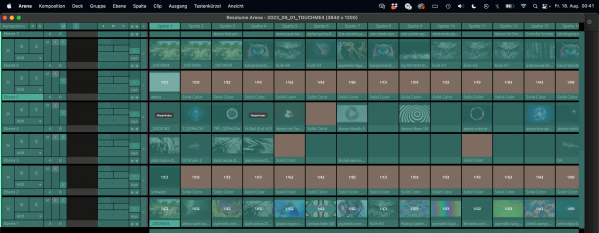

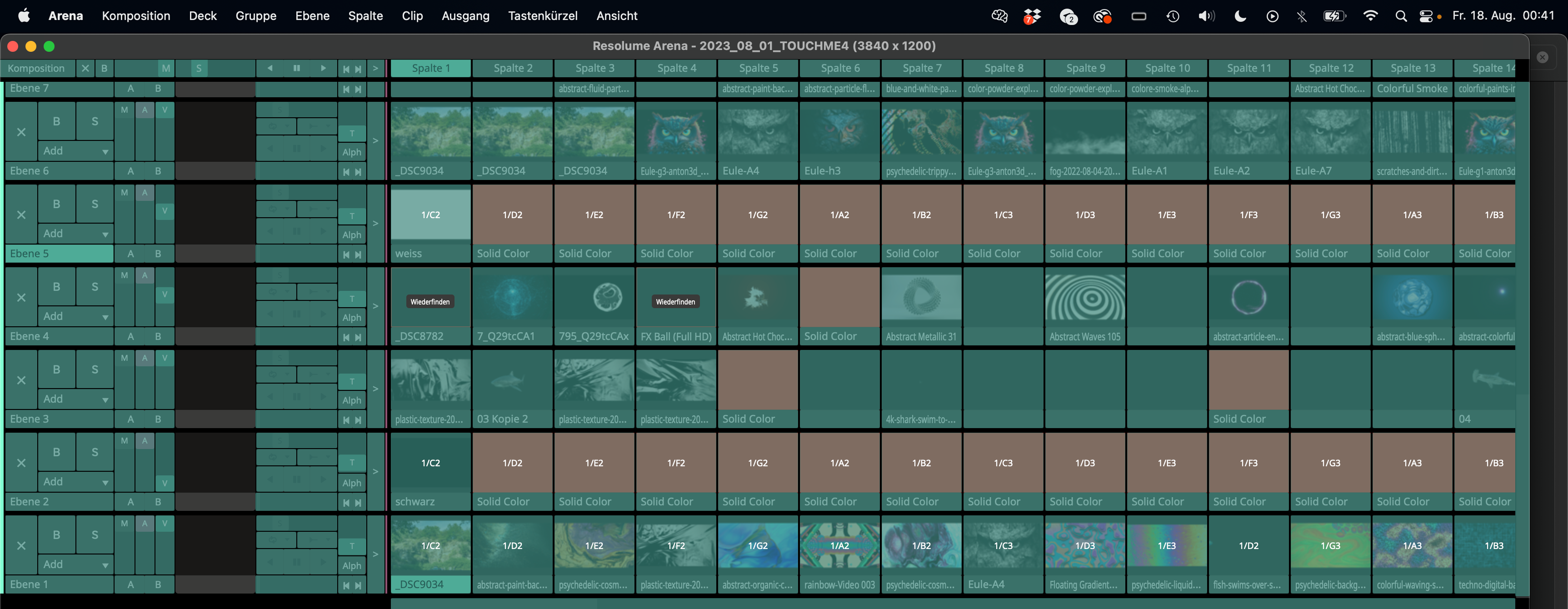

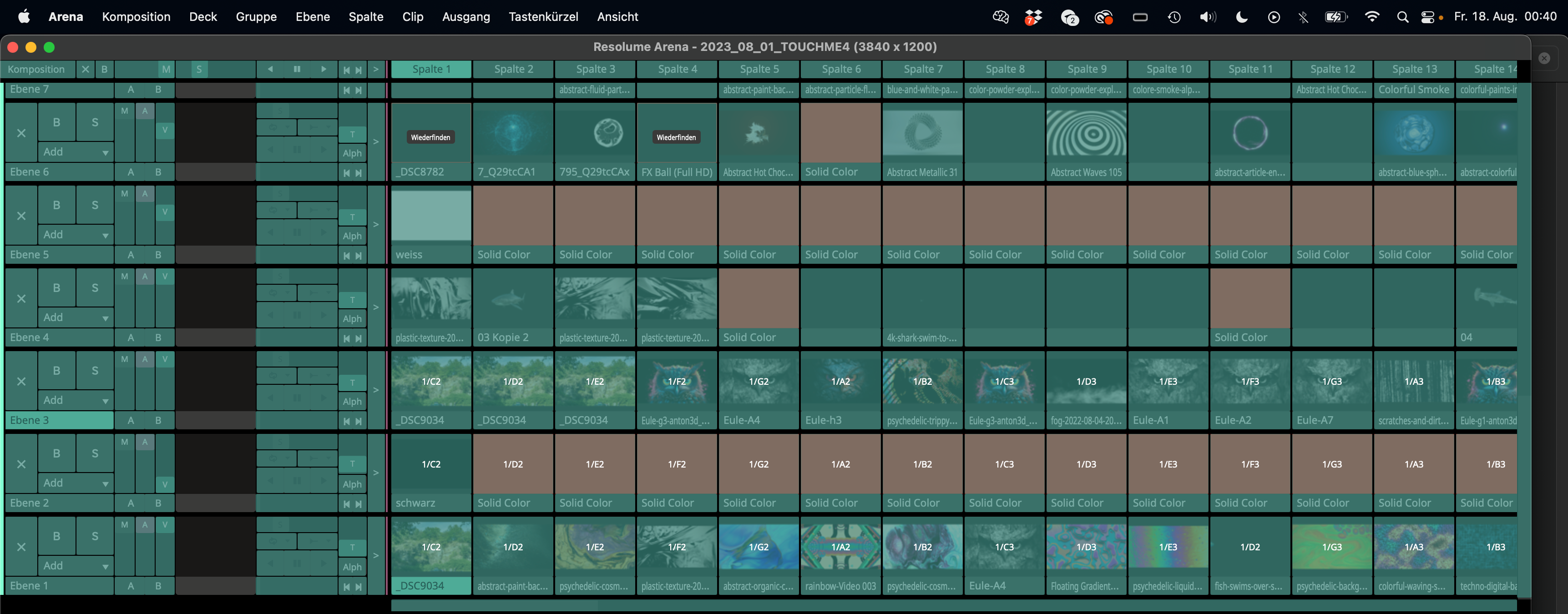

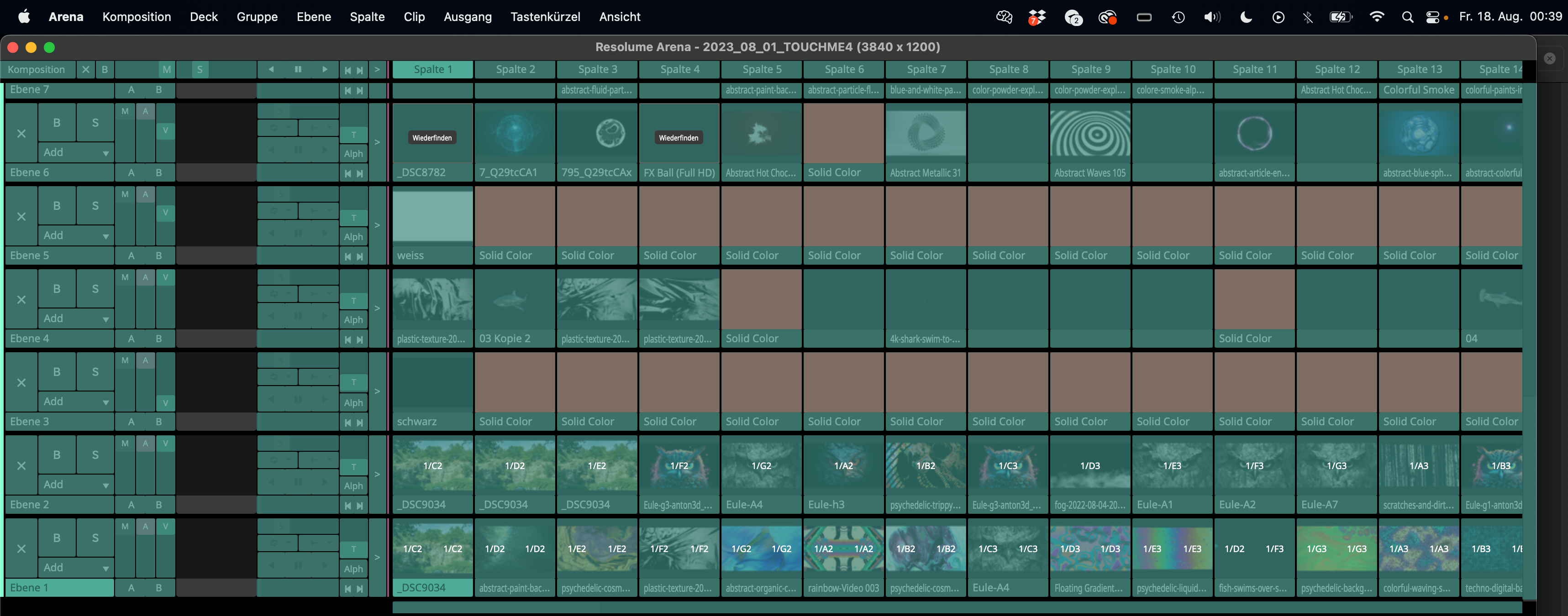

during my last immersive installation using the touch me sensor I found arena behaving weird.
Once in a while after changing parameters of any clip or layer, the whole row of midi mapped clips switch to another row. When I try to redo the mess and move the layer, sometimes the midi mappings stay at the same layer, and sometimes they jump to another one. Is there a logic behind it? Maybe someone has an idea what is happening?
greetings, Anton
Posts: 7820
Re: jumping midi mapping
I think you have that row of notes mapped with Selected Layer target.
https://resolume.com/support/en/midi-sh ... cut-target
