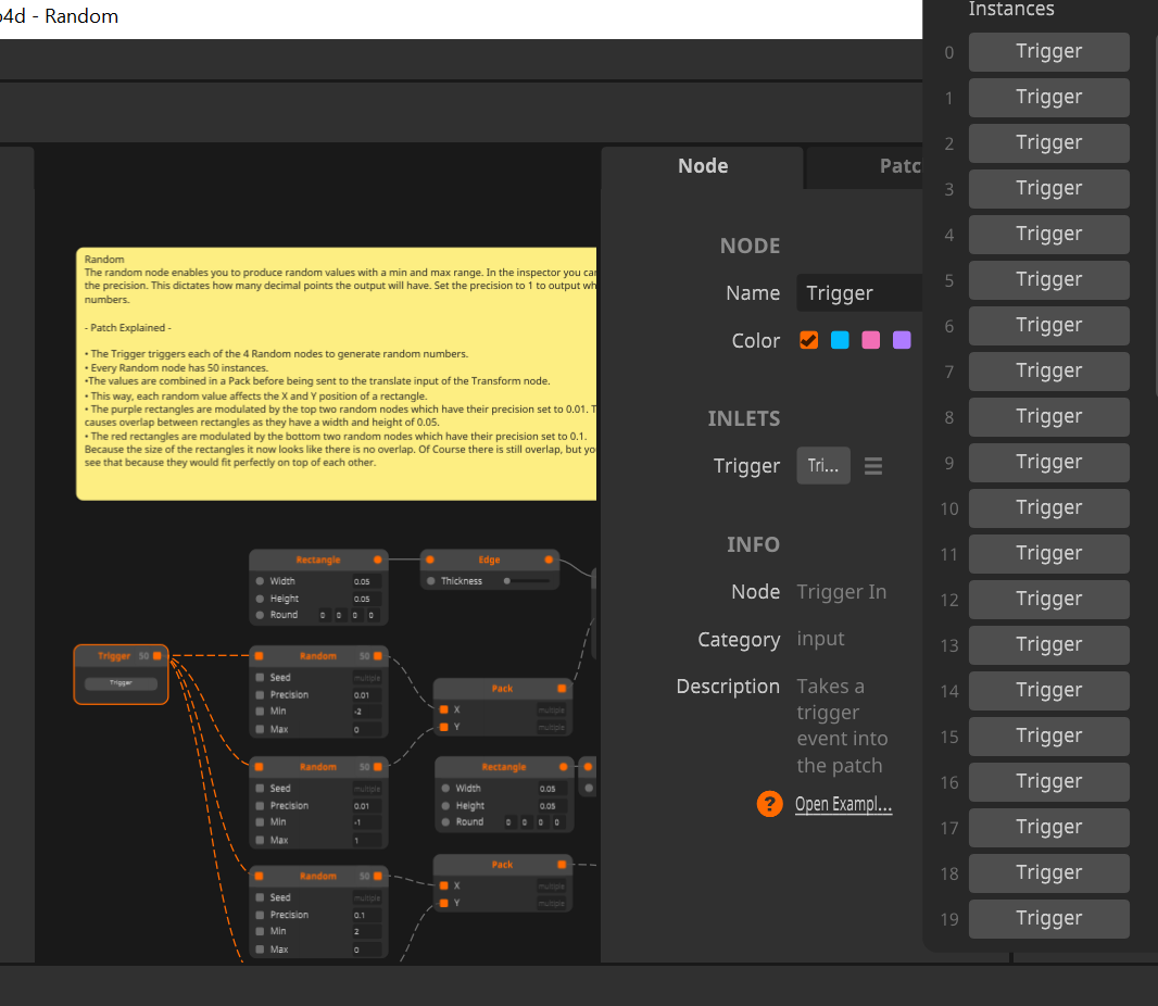

Create a random node, and click example in the node panel, and you get a trigger with a 50 instance count, that if you detach, you can see it has a list in its input, but you can't change the count.
The IntIn needs to be set to event, but now I see a repeat node (in the help patch), which looks useful, thanks
Re: Instance Counts and some thoughts on first use
I'm getting something different under the Random Node's tut's
Can you create a 'Trigger In' node then connect that to an 'Expand' Node?

Question for both Cat and Arvol: which versions of Wire are you running. It seems that Cat is using an older version, I've updated the Random example recently to the version Arvol is seeing.
