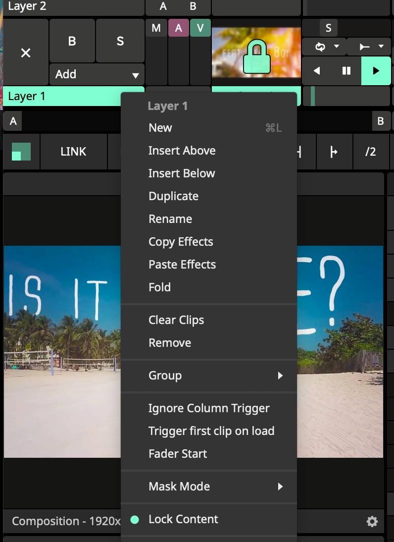

If layer transition time is enabled, then it would take a few seconds for layers to clear.
https://resolume.com/support/en/layers#layer-transition
Layer content can also be locked.

Nope, none of this. Doubled checked. It's weird, because i can physically watch the blue selection go in and out when there is no content on the layer, signifying the cue is triggered, but with content it does nothing.
