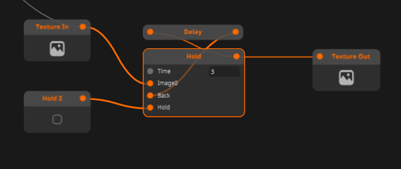

I expected buffer to do this via the pop button, but it seems to just constantly refill the buffer, so how to sample and hold an image?
Posts: 7771
Re: Sample and Hold an Image
Gate with feedback to an inlet.

I think doing the hold in a shader is the simplest way to be honest.
The below into a isf shader and use
as the patch
Code: Select all
    "CREDIT": "",
    "DESCRIPTION": "",
    "CATEGORIES": [ "generator" ],
    "INPUTS": [
            "TYPE": "image",
            "NAME": "image0"
            "TYPE": "image",
            "NAME": "back"
            "TYPE": "bool",
            "NAME": "hold"
void main() {
	vec2 uv = isf_FragNormCoord.xy ;
	vec4 back = IMG_NORM_PIXEL(back, uv );
	vec4 col = IMG_NORM_PIXEL(image0, uv);
	 if (hold==true){
		gl_FragColor = back;
	}else{
	 gl_FragColor = col;
