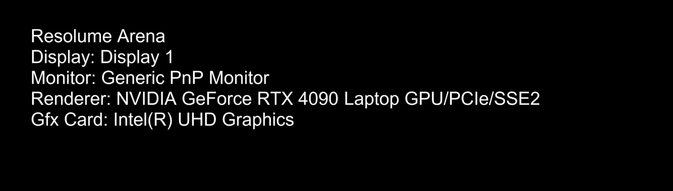

If you enable show display info in Resolume output menu, and send a windowed output to your main display, what does it says as GFX card and renderer?

Attached

So through the MSI Center I changed it to Discrete Graphics Mode which seems to work good now. Stress testing with 3 outputs and 6 layers to see if the problem is solved.
