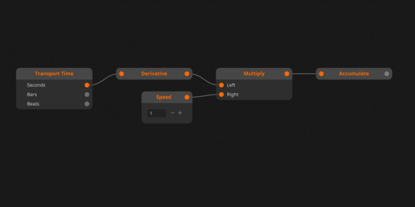

You do not want to increase with the same fixed value each frame, because then if you run at 200 fps it will go faster than if you run at 30 fps. You want to have something time dependent. This works quite well and allow you to have a speed parameter too :

We should really make a node that does this - This is not a solution a non-developer would come up with

thankyou for sharing this!flyingrub wrote: Fri May 17, 2024 18:37 You do not want to increase with the same fixed value each frame, because then if you run at 200 fps it will go faster than if you run at 30 fps. You want to have something time dependent. This works quite well and allow you to have a speed parameter too :
Re: metaballs time problem
This is why you need sub patching and a sharable library, so you have 1 node that does what a bunch do and you don't have to repatch it everytime you need it...MarkyMark wrote: Tue May 21, 2024 15:06 We should really make a node that does this - This is not a solution a non-developer would come up with![]()
