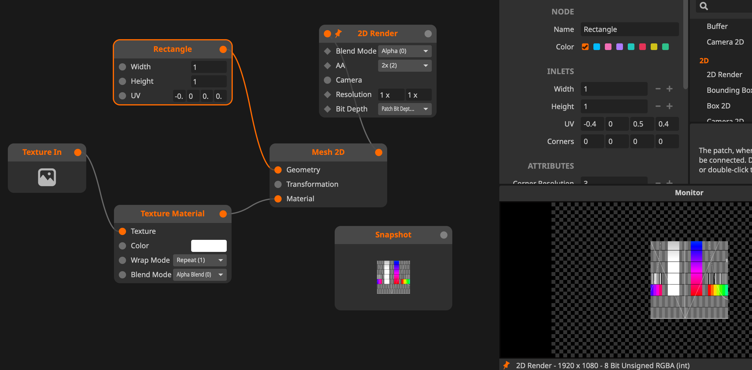

The node setups I tried don't show a difference for me. For me the patches keep the texture wrapping setting when opening them in 7.20
For example this is the same in 7.15 and 7.20.
Could you send us a patch where you see different output in 7.19 vs 7.20?
