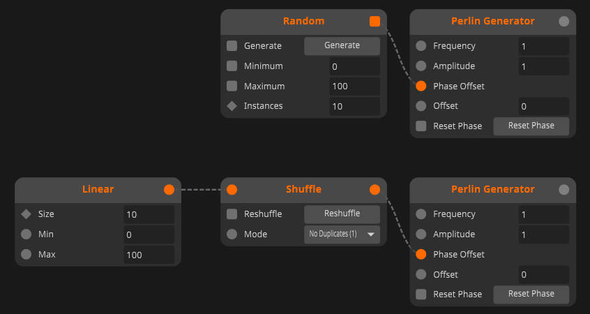

The "Seed"-inlet shouldn't be there, but you can get a random result with using the "Phase Offset"-inlet.
The phase offset does not create a new uinique random seed, you could see it as shifting the starting point of the noise animation.
If the phase offset values are far enough from each other it will appear random, these two solutions should for example work to get you random-looking outputs:
