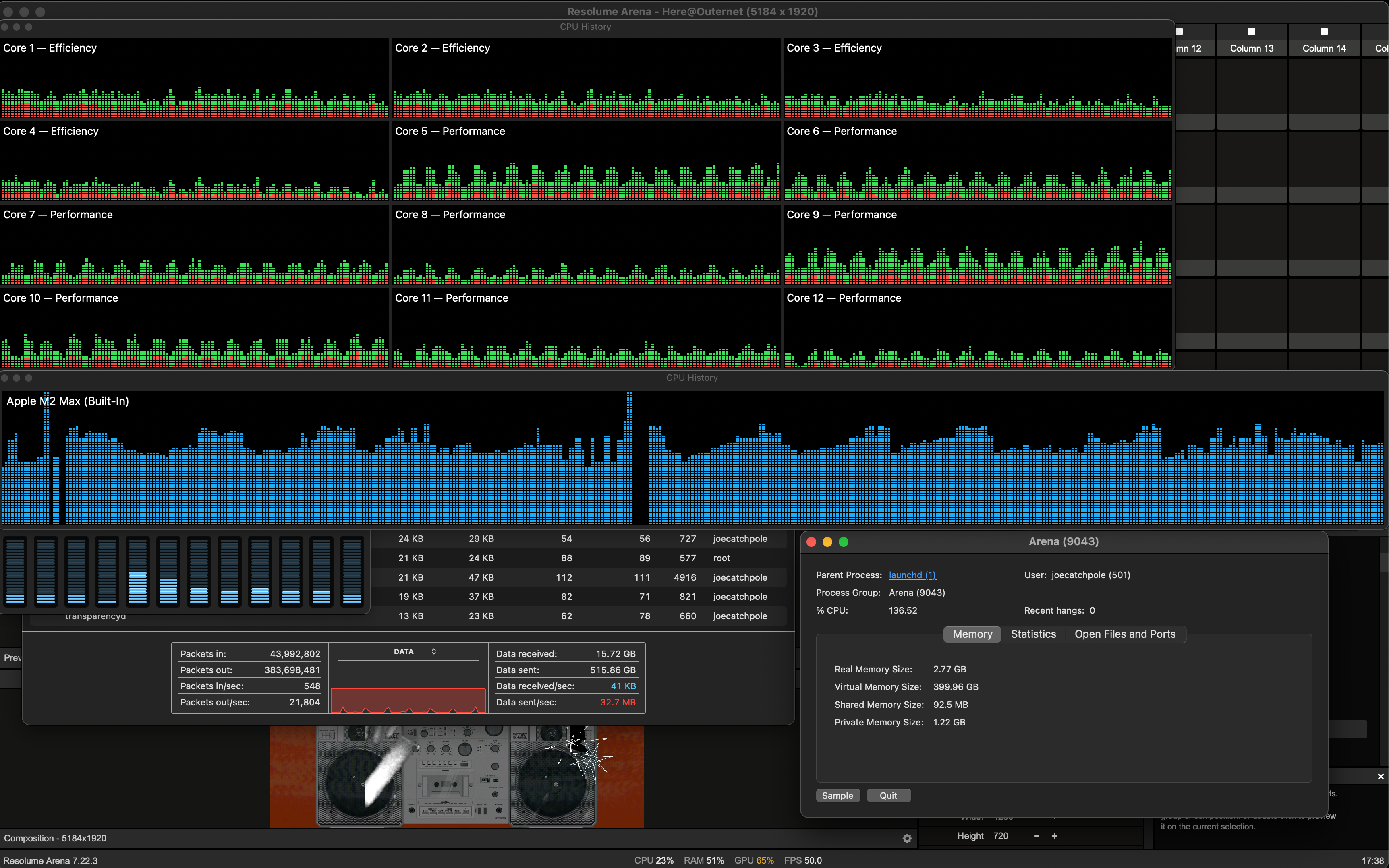

The one thing I've found which works for me is to use Advanced output to NDI with the Alpha channel switched off rather than NDI streaming the composition from the output menu. This seems to save just enough resources (about 25%) in the encoding and transfer stages of the process. I've been studying Activity Monitor but can't see where the system is explicitly struggling. All 12 CPU cores are running under 50%, GPU 50%-70% with occassional spikes to 100% but that does not coincide with the stutters.
