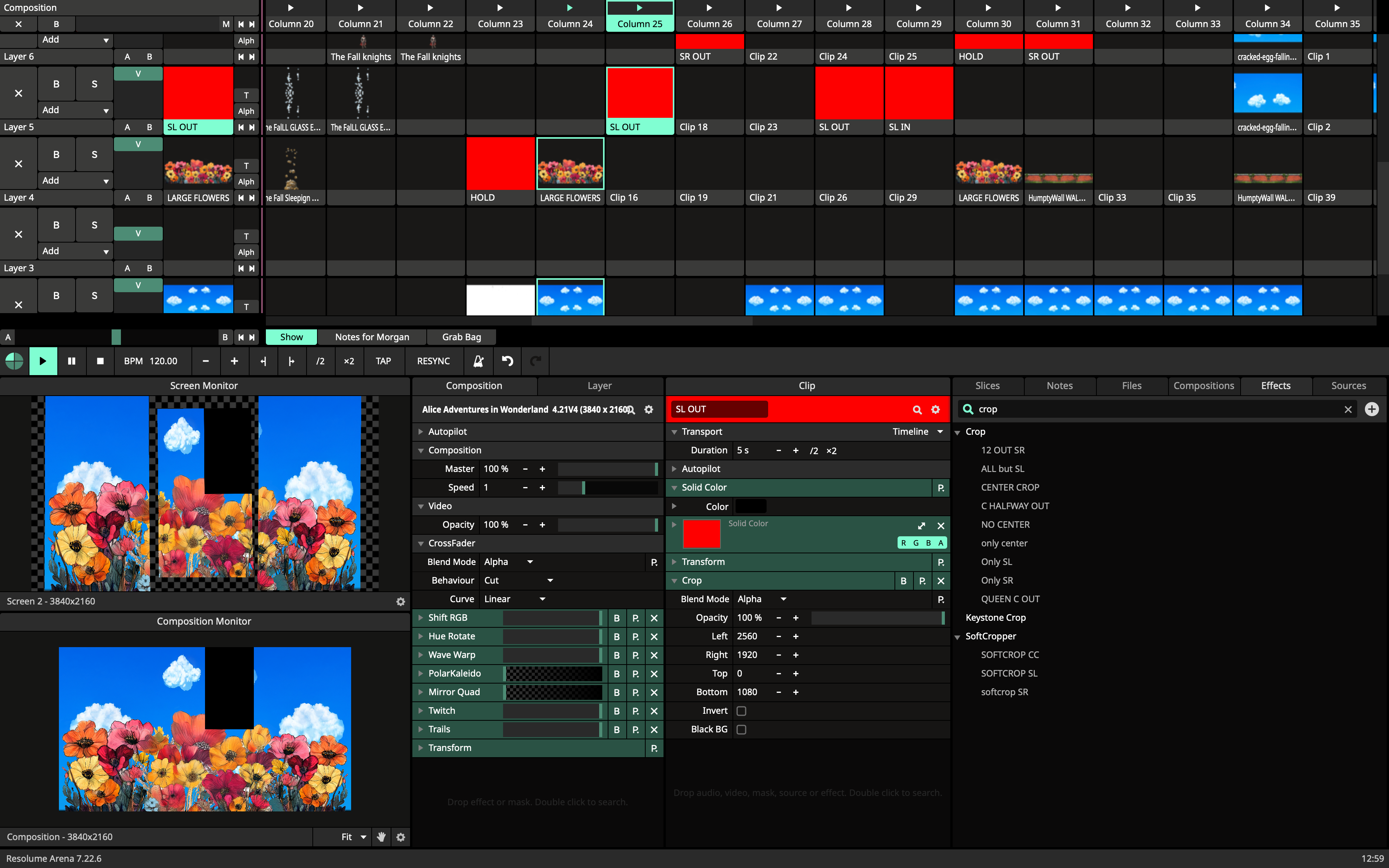

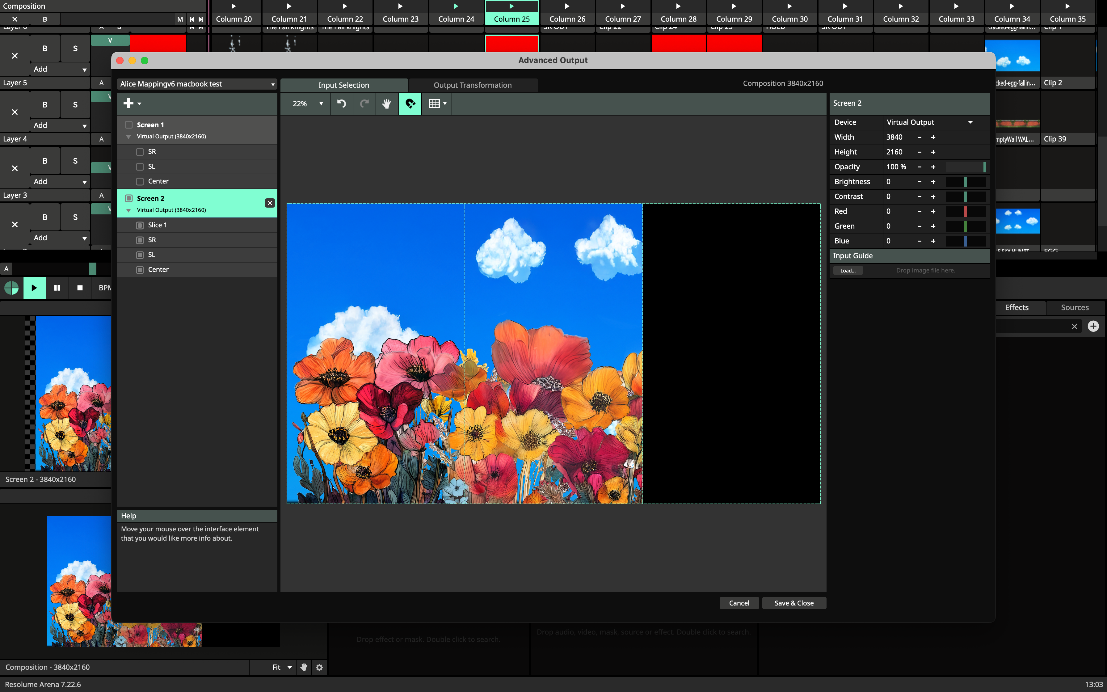

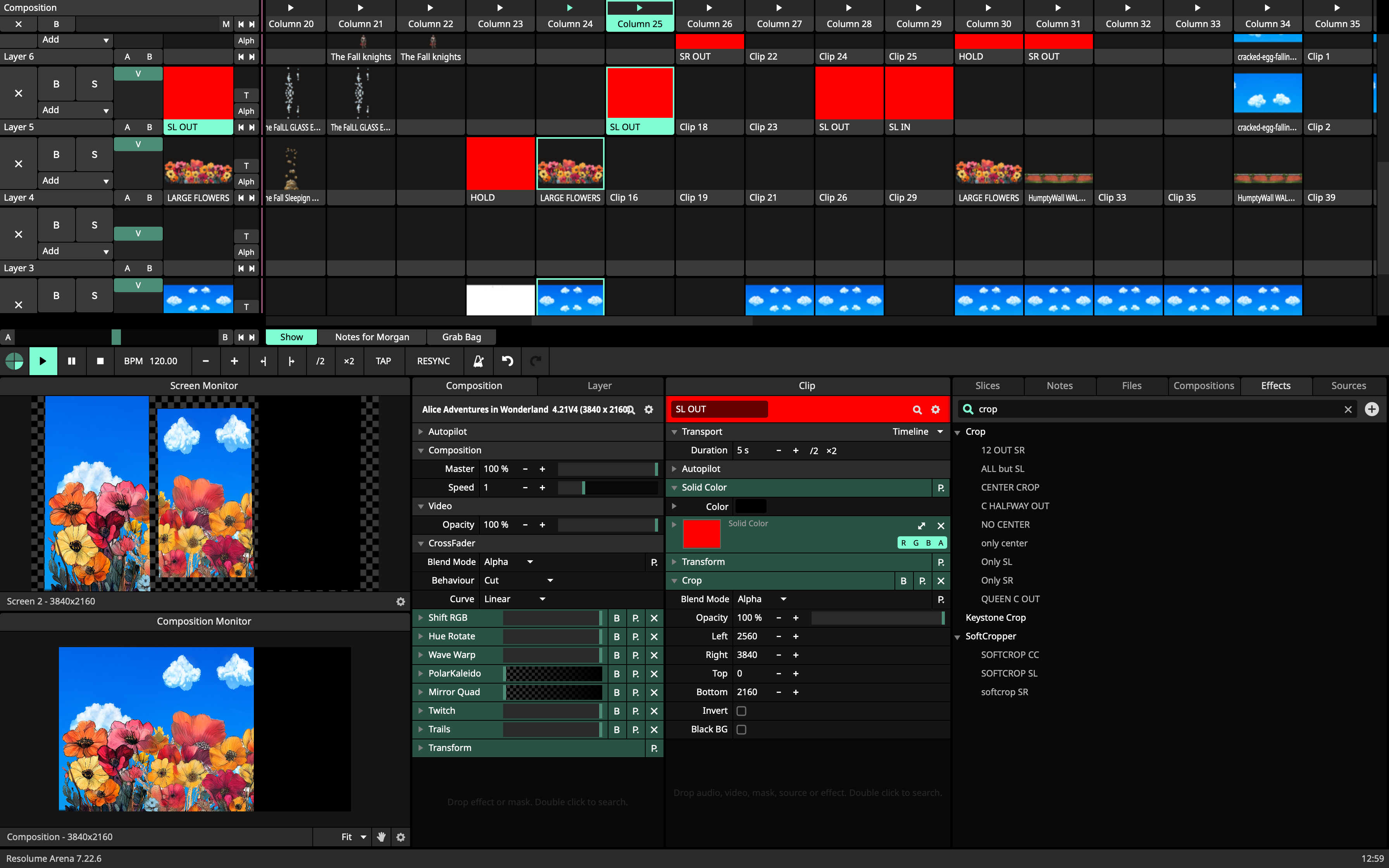

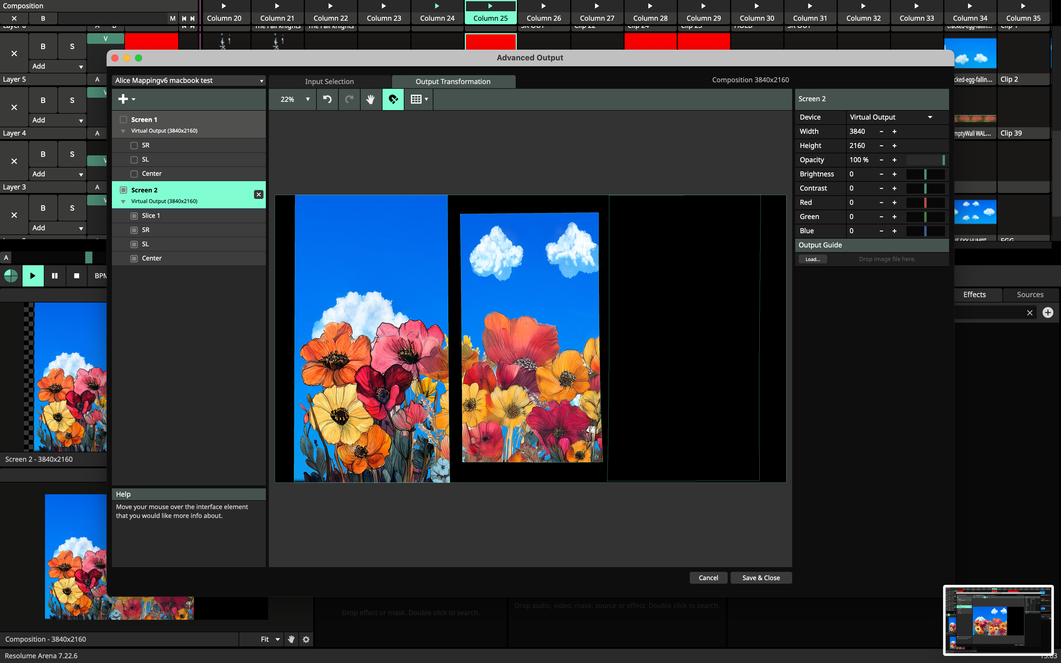

I use the crop effect in resolume. then set presets for that effect. depending on the image I sometimes use transform adjustments, but not usually. I am having issues with crop regardless of whether transform values have been altered or not. Transform data holds when composition is reloaded but not crop. This is a big problem as the show opens tomorrow and my operator cannot be expected to be able to update this much everyday.

Hi all,
Corroborating that indeed things are not working correctly. Morgan (membry) reached out for me to troubleshoot, and it looks like her presets are getting corrupted somehow. I'm seeing a lot of
"<PhaseSourceStatic name="PhaseSourceStatic" phase="0.15625"/>"
in the corrupt versions, but just <PhaseSourceStatic name="PhaseSourceStatic"> in a new preset I make fresh. When I apply the corrupted preset, any crop values above 1920x1080 seem to snap back to those as their maximum upon saving and reloading Resolume.
When applying a new preset with the exact same values, the values remain just fine. Same for if I manually type in values in the crop effect. But applying the corrupted preset seems to kill the effect from saving values properly.
