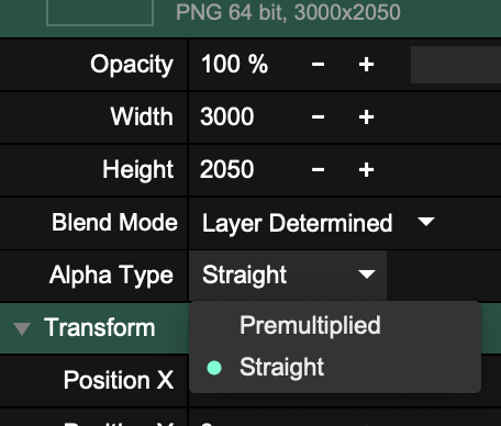

The stored pixel values are encoded as they are, the alpha type is not stored, you can change it in the clip panel after loading:
- Attachments
- Képernyőfotó 2025-05-20 - 10.05.16.png (48.17 KiB) Viewed 14209 times

Hi there! No, sorry, I'm talking about Alley. Resolume has that dropdown, sure, but I don't see such a feature in Alley, right?
It's not a huge deal, but it does mean that when I batch transcode a bunch of stuff in Alley, I have to pick out the ones with Straight Alpha and do it in something like Media Encoder instead, which is a bit annoying.

If you convert files with alpha to a format with alpha, Alley should do that without touching the alpha type.
Then you can still select the type in Resolume.
