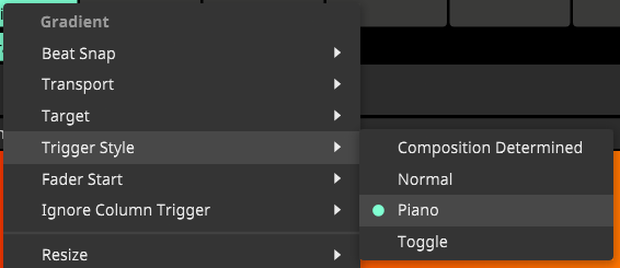

Here is one idea how this could be done:
Set your clips to 'Trigger Style' --> 'Piano', this way they will only play while you keep your key pressed:
Screenshot 2025-09-09 100549.png (22.97 KiB) Viewed 16715 times

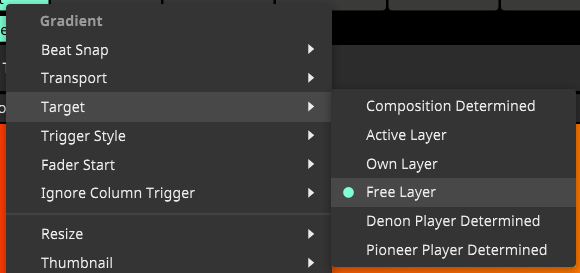

Think about how many of the temporary clips you need at once. Create this amount of layers, no need to create 25 layers if you're only playing 4 clips at the same time. Create 4 additional layers and set the clip 'Target' to 'Free Layer':
Screenshot 2025-09-09 100447.png (29.76 KiB) Viewed 16715 times
For a softer fade set the layer transition time of those layers to a short transition.
Would this work for you?
laiman
Joined: Mon Sep 08, 2025 22:21
Re: Triggering clips with piano midi keyboard issues
Post by laiman »
Thank you so much Chris ! that was exactly what i needed .
