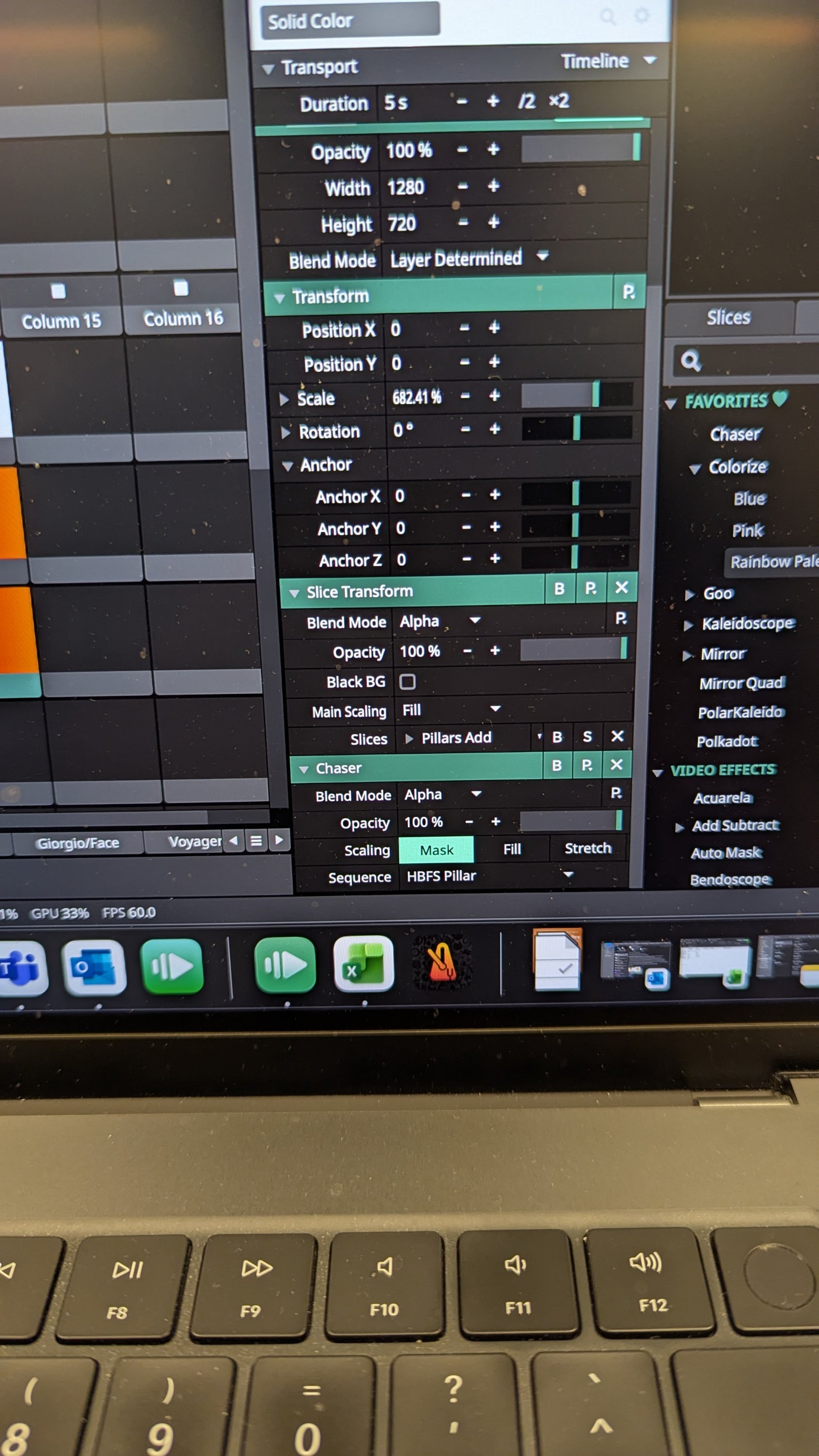

I've also attached a foto of how it looks when chaser is not loading (no steps and echo/sustain/release option).
also i've noticed that resolume shows the wrong step number despite playing the correct one. For example it sais step 1 but the slider is clearly further and the step that is played is number 4.
