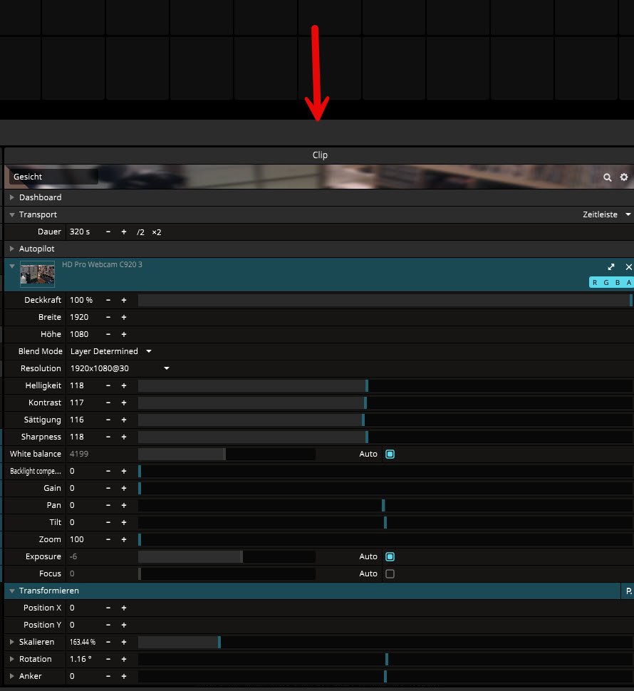

I can't really describe it exactly...
See image: the entire clip area flickers involuntarily,
But ONLY the clip area. Preview and Explorer are all normal.
I've closed the clip window and resized it. No change. It doesn't matter which clips are selected.
Latest Avenue version and I've had this problem since the last update.
Does anyone have any ideas?

any NDI or camera sources in the composition?

Re: Clip area flickers
Post by exelbonsai »
Oh, sorry, I just read this.
Thanks for your reply.
Yes, I have several NDI components. The strange thing is, sometimes it works without flickering, sometimes with it; I can't reproduce it.
It's definitely gone when I generate a new project. I'll try adding only NDI to see if that's the cause.

Hello
I forgot to reply because I found the solution.
It only flickers when an NDI source is inserted into a clip but isn't online.
If the source, e.g., Virtual-DJ > NDI out, is online, then the flickering disappears.
Perhaps it's a bug that can be fixed; otherwise, I now know what's causing it.
And if it's (once again) only happening to me, we'll have to talk again.
