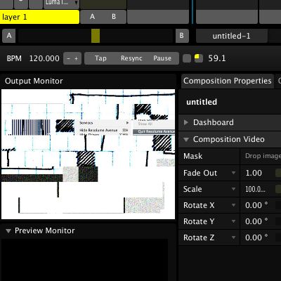

I am narrowing the problem down.
I am not familiar with the software architecture but is there something like an image cache, where the images that come in are "collected"?
I think that is the problem.
It does the same thing with the build in Isight camera:
When I start up the video source it gives a picture of random images that I played in other programs minutes ago and weird stuff that is nowhere on screen. see here:
So the question is: How and where are the images loaded in resolume before they go "on screen"?

yeah I think the problem was adressed in the last release, I didn't have the chance to test it yet, but will soon, I hope that it is fixed!
the isight is working fine now in my system as well..
although the latency is still a bit annoying, but I guess that's normal if you mix it in a software...
