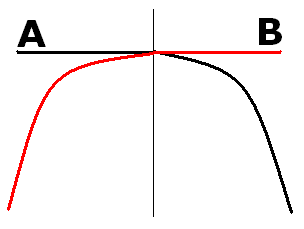

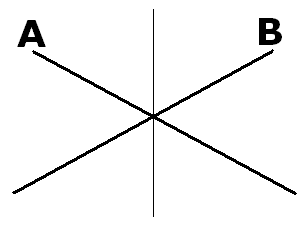

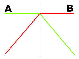

    *) can you add a knob to adjust the time a A-B transition takes. (maybe also at BPM basis)
    *) add more presets (pls. see pictures) - I think the first picture shows the currently implemented transition style!?
