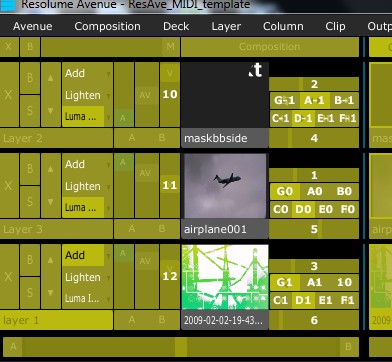

I see. as i said i'm still testing avenue - what happen to the midi mapping method? i cant map each layer individually? i cant assign midi note to effects? i cant map each layer opacity or make layer 2 or 3 play only?
how can assign midi notes to play-pause- random and no matter which layer i'm using?

VJ99p wrote:i cant map each layer individually?
No this is unfortunately not possible yet but we are working on this.

Not possible?? huh... this is strange... or maybe I just don't understand the problem ;)
I bet I mapped 3 different layers individually this weekend without any problem...
I connected: scale / opacity / size and anchor parameters from 3 different layers to different CC parameters in FruityLoops... (all thrue 1 MIDI channel)
Worked like it supposed to imho... (mapping on -> click the desired parameter -> move knob on MIDI out in FruityLoops -> get the CC number in the yellow mapping field)
Made some automation tracks for all the CC parameters and they just started to move in Resolume when I started FruityLoops... (all 3 layers independent)

Yeah, I'm confused. Mapping the active layer is possible with application layer mapping mode, and mapping individual layers is possible with application deck mapping mode.

Yes, you map opacity etc for each layer by selecting Focus: Deck when mapping. But mapping the transport controlls for each layer does not work as expected.

As we speak I have bounded 21 MIDI notes and 6 CC parameters to 3 different layers transport controls (play forward / play backward / etc...). So actually 7 MIDI notes and 2 CC parameters per layer individual... It's really working fine here...
Although!!! I first deleted the preconfigured MIDI mapping which loads to Layer 1 clips (C0-D0-E0-F0.. etc...)
Before deleting this standard mapping I got conflicts because of this! Actually I just deleted all standard mappings before I started mapping my own controls.
(I found that it's not posible to map the transportcontrols if there is no clip / or a still image(jpg) loaded to that layer!!)
[edit] When set to "play once" in the layer transport controls, the clip unloads from that specific layer after it's been played once (like normal i guess)... After that, there is no visual (yellow) feedback from the buttons when a MIDI note is pressed for that layer transport controls, it's still there though ;) ! )

GeeEs - from your Attachment I see that you managed to map all Three layers? the default in Avenue gives you the choise only for one layer. can write down here what you change? where?

So just by deleting the preconfigured MIDI mapping file you were able to do this? I wonder how that works. I'm not using the default, although my mapping config is based of the default file, I just saved under a new name after I did my mapping. You think some controls get unlocked if there is no midiconfig for resoulume to read when the app is launched?
