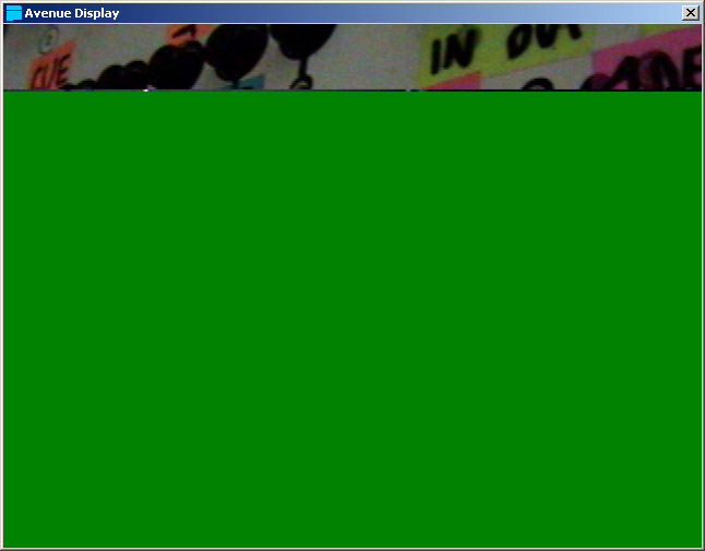

I'm trying to get a live composite video feed into Resolume 3.1.1 via a USB capture device (Pinnacle Studio Moviebox 11). When I double-click it in sources, I can check from the properties that the signal is detected. But when I play the source on a layer, it shows up an image that is mostly green, but with a small stripe of some old frame on top (see picture). The stripe at the top is always from the frame that was being captured at the time I inserted the source into a deck (in other words, it does not change if I re-insert the source into a layer, but does if I clear the source from the deck and re-insert it then).
In Resolume 2, there is a separate "format" button that appears when I double click on the Pinnacle source. Does this exist in Avenue? Maybe it has nothing to do with this, just a thought since I couldn't find it..
Would be nice to get some insight into this issue. Just to make things clear, the live capture from this device works fine in R2.41.

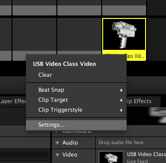

Re: Resolume 3(.1.1) Capture problem
You can configure the capture driver by right-clicking the clip name and then choose "Settings". The capture driver window then appears and hopefully you can then configure it correctly so it works. Let us know if it does or not.
