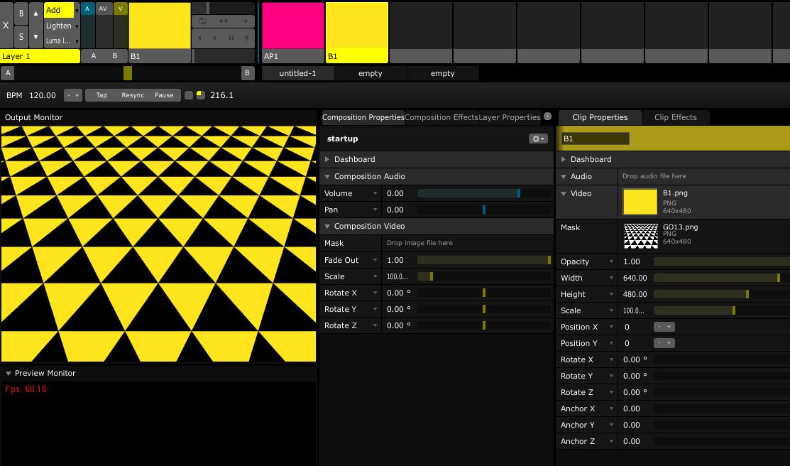

Hi there,
I'm having some problems with masks on a per clip basis.

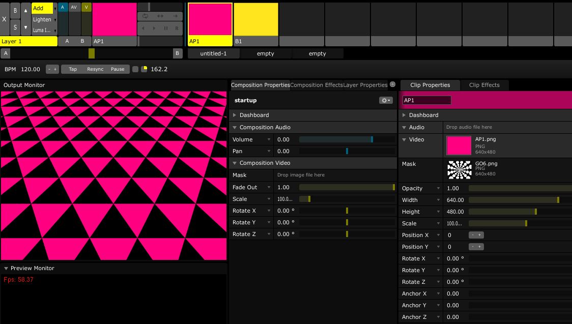

I have 2 png files one red one blue, different mask per clip (grayscale .png same size as clip). When I launch the red clip it plays fine, displays the clip with the appropriate mask. When I launch the Blue it will continue to play the mask from the red clip.
Seems to happen when using the solid source too.
Resolume 3.3.1
Macbook Pro

No, definitely on the clip. Fresh scene two clips, two masks. no mask on layer or composition.

i had the same problems with .png masks, i put some masks on clips and first everything ran fine, but then resolume started to play clips with wrong masks. i checked three times if everything is applied right, it's really weird... at the moment i don't use masks at clips, just at layers because that works fine.
