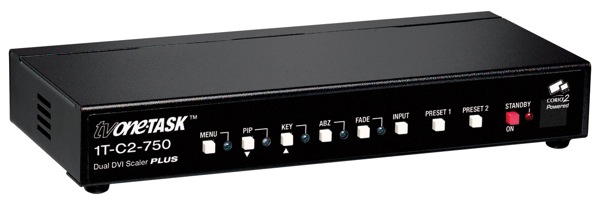

It's all about this little gizmo, the TV One 1T-C2-750 Dual DVI mixer. It's quite a handy little device, that straight out of the box allows you to switch or fade between two DVI sources, and can output up to 2048x2048 in resolution. With some tweaking/tinkering it can also be pushed to TripleHead2Go rez. Aside from that, it also supports luma/chroma keying, and picture in picture. And all this for a list price of around $900.

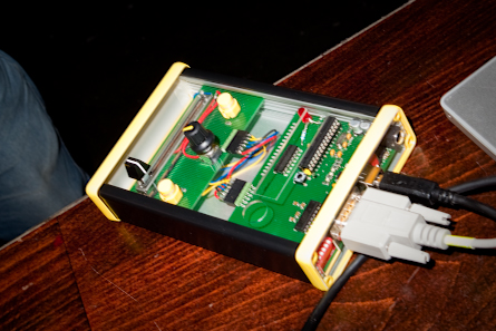

First off the bat was Toby Harris, who first started mentioning an out of the box, all hardware mixing solution based on the device. Unfortunately, at the time of writing this, the product is still in the prototype stage. The glimpse some of us were fortunate enough to catch at the Visual Berlin Festival in 2010 was great, and we can only hope it goes into production soon.
Image by Andreas Apelqvist
