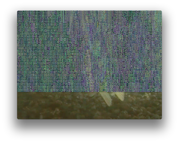

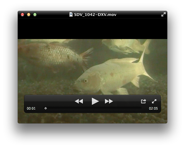

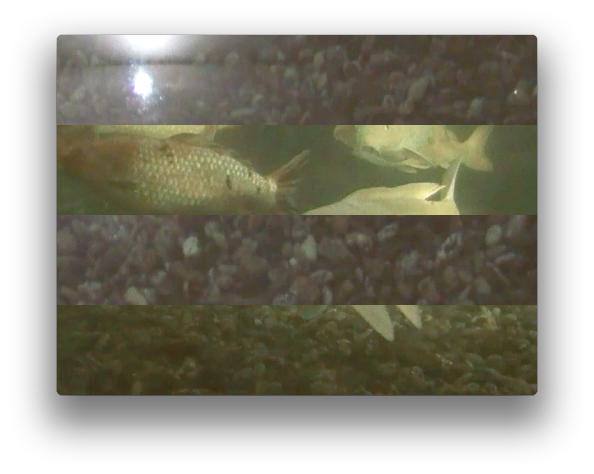

I just experienced some problems with DXV encoding. It seems that the encoder scrambles different footage encoded at the same time. The result looks like this:

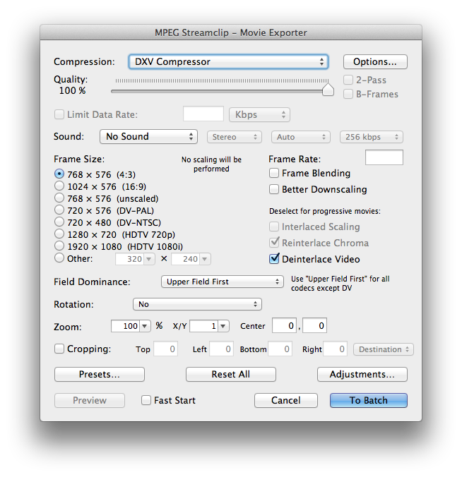

This happens when I upscale footage from 720x576, H.264, AAC to 768x576, DXV, no audio
  1. Close all video playback software (QT, MPEG Streamclip, etc.)
  2. Open MPEG Streamclip 1.9.2 (same with Quicktime Player 7)
  3. Open batch list (List/ Batch List)
  4. Drag & drop 2 video files
  5. Export to Quicktime / DXV/ no Alpha / no Audio / choose higher resolution!
  6. encode simultaneously

I can hover confirm, that Quicktime 7 produced also corrupted files (I guess Quicktime X or MPEG Streamclip was opened at the same time)
Posts: 2245
Re: DXV 2.2 encoding - multithread problem
I just tried and can confirm that with mpegstreamclip DXV 2.1.1 does work fine with multiple renders but 2.2 indeed does not, we'll have a look to see what's wrong. Thanks for reporting this to us!
