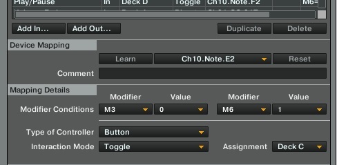

you can see in this screen shot that next to each assigned midi control, you get 2 assignable modifiers per assigned control.
the first dropdown choose which modifier and the second chooses a value.
so you can make statments like "if modifier 3 = 0"
using both you can make more exclusive statments "if modifier 3 = 0 and modifier 6 = 1"
