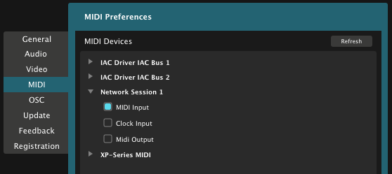

It should be a matter of following the steps to connect your iPad over a wifi network (http://beatsurfing.net/support/resources/) and then checking midi input for the network session in Resolume. If you can't figure it out, please let us know if you're using a Mac or PC so we can post some screenshots.

After you have connected Beatsurfing and your computer, make sure you have enabled midi coming in from the network session you are connected via.
Then it should just be a matter of entering Application Midi Map, choosing one of the yellow highlighted clips, and pressing one of the buttons.
Let me know if that helps.

Thanks! I managed to get it to work, not perfect, but it connects and I can now focus on figuring out everything rather than being stuck in the beginning!
