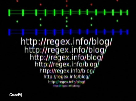

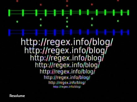

Hi everyone!
Have some questions.
I'm preparing for some events, where i plan to use multiple live inputs in resolume (v4.1). Currently testing different harware for quality and stability. I found that resolume is using bad deinterlace method: looks like resa just drops one field=2x reduction in vertical resolution. Is it possible to implement other method for deinterlace - something like "blend fields", which gives much better result.
p.s. tested deinterlace in GrandVJ - much better result. If needed - can take screenshots.
Warspite
Posts: 153
Joined: Thu Nov 01, 2012 14:36
Re: Deinterlace method in Resolume.
Post by Warspite »
CVBS input - test pattern crop
GrandVJ Deinterlace.jpg (63.77 KiB) Viewed 16291 times
Resolume Deinterlace.jpg (51.45 KiB) Viewed 16291 times

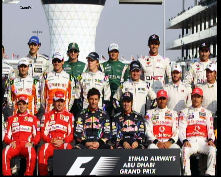

Another example:
GrandVJ Deinterlace 02.jpg (154.25 KiB) Viewed 16290 times
Resolume Deinterlace 02.jpg (178.54 KiB) Viewed 16290 times
Thanks for the screenshots. In general, improving de-interlacing is a low priority for us, but we'll give it a look.
