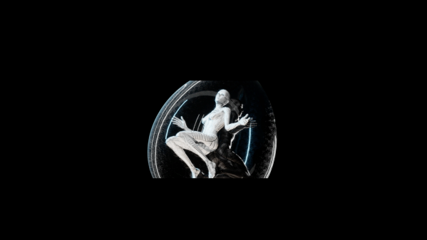

My actual screen:

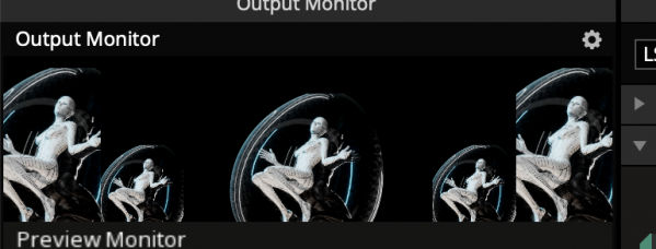

My output monitor:

Set the slice in the advanced output setup back to Composition source.
https://resolume.com/support/en/slice-routing
