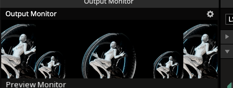

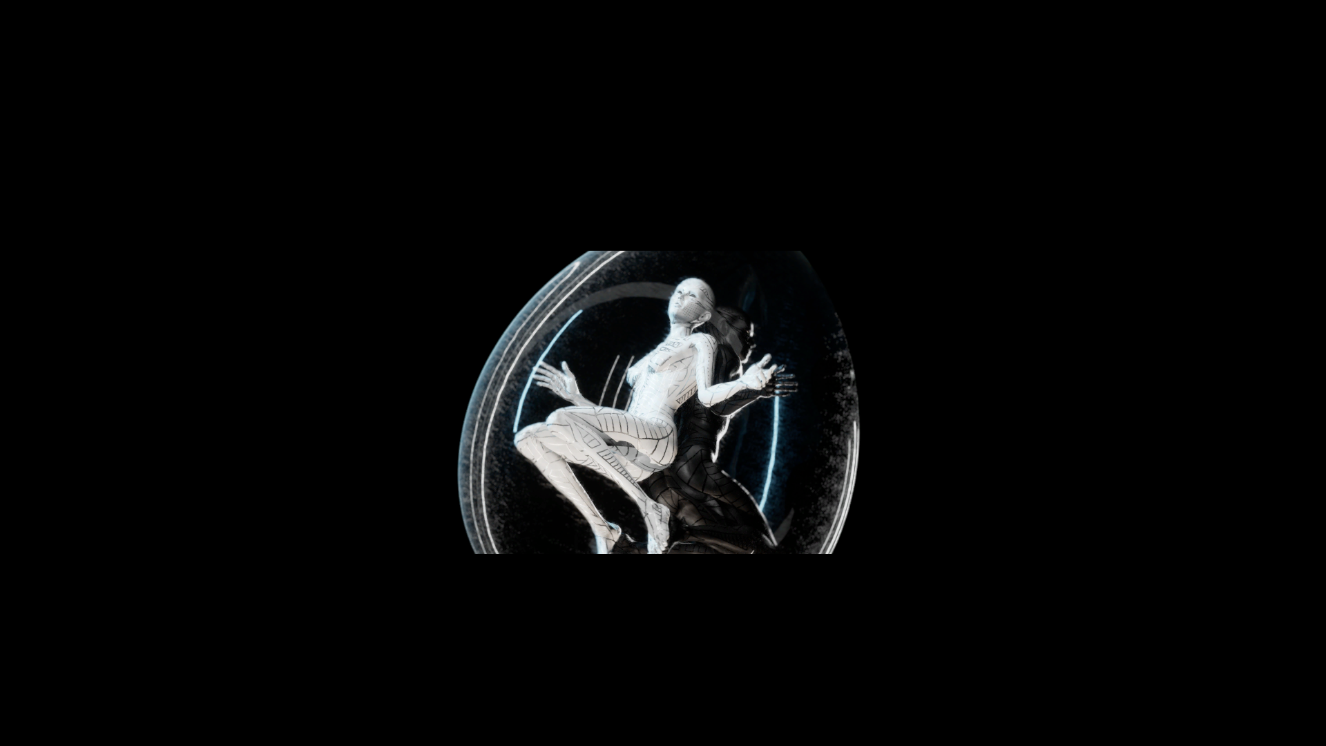

I have slice transformer on my composition and I can see it working in my output monitor. However, it's not doing anything on the actual screen.
My actual screen:
My output monitor:
Any idea how I fix this?

Set the slice in the advanced output setup back to Composition source.
https://resolume.com/support/en/slice-routing
