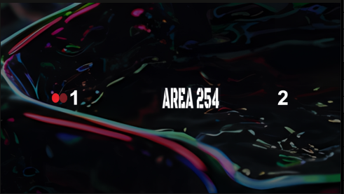

I've noticed something, and I don't know if it's a bug or what it really could be, but with a slice of 2566x1680 (for example), if I drop an FHD (1920x1080) screenshot directly into the project, drag it, and only slightly enlarge it to fit within the slice size, it has better quality than when I use the SLICE effect on that screenshot (where even at its original size, it's small). However, when I leave it at the full slice size, it loses quality... this is just an example from a PowerPoint presentation with a lot of text. Why does this happen when using SLICE on images, videos, and sources?

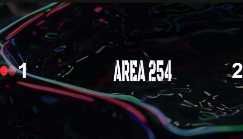

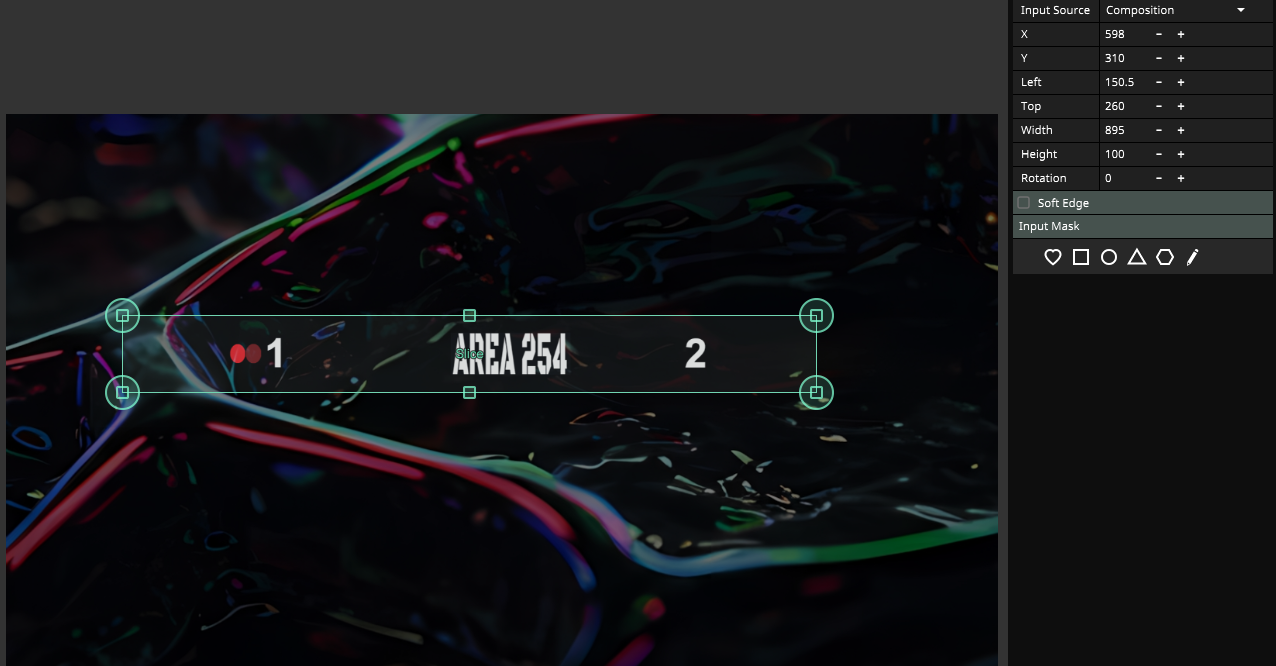

If I have a Slice of 895x100. and my media is 895x100
If I Transform it into the slice, the size is tiny and I have to scale the video 200% to 1000%.
I would have thought that making the media the same size as the slice would have made everything correct and would avoid me scaling.

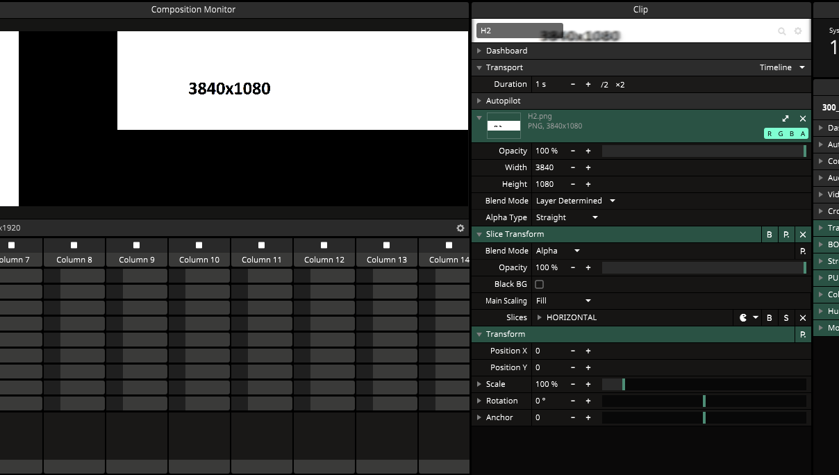

Have you tried placing your slice transform effect above the native transform effect of the clip?
samirbridi
Posts: 38
Joined: Sat Dec 17, 2022 01:29
Re: REAL SIZE VIDEO/IMAGE INSIDE THE SLICE
Post by samirbridi »
Christoph wrote: Sun Dec 21, 2025 23:01 Have you tried placing your slice transform effect above the native transform effect of the clip?
In my case, I always apply the "slice" I want to use to the video/image directly without moving its position.
I think it's worth a try, but I shouldn't have to do that every time, right?

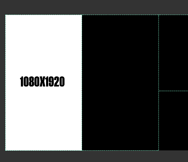

What I realized using this solution:

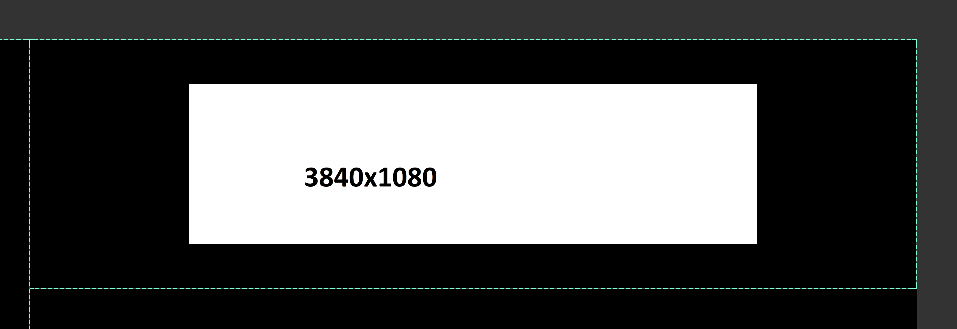

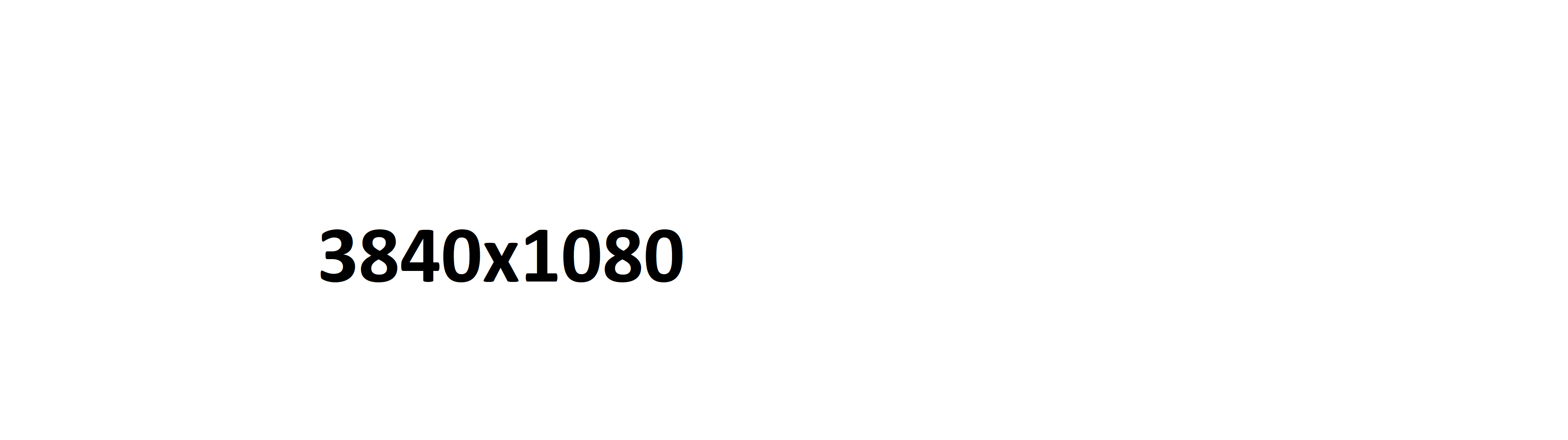

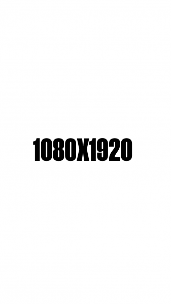

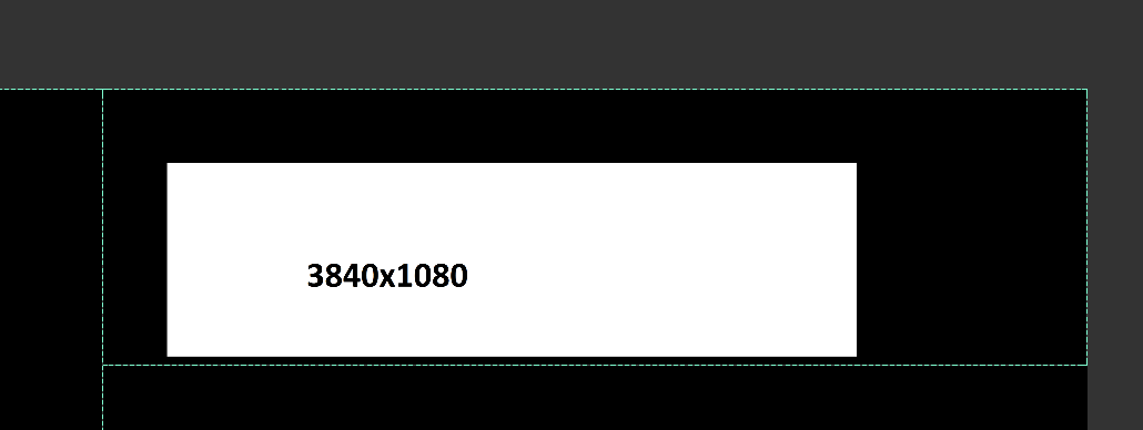

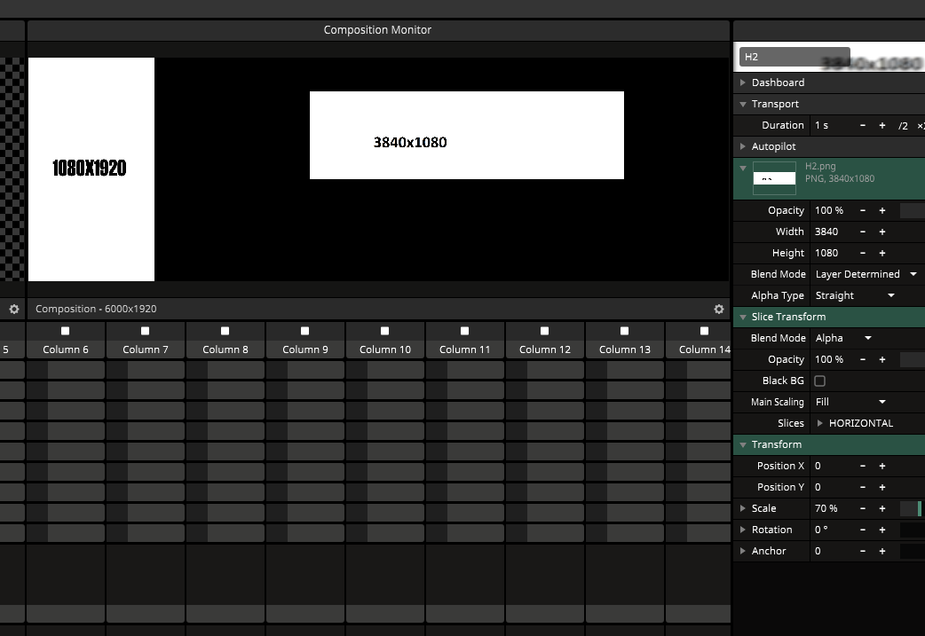

In the case of 1080x1920 images (vertical FHD), when slicing, it managed to fit within the size.

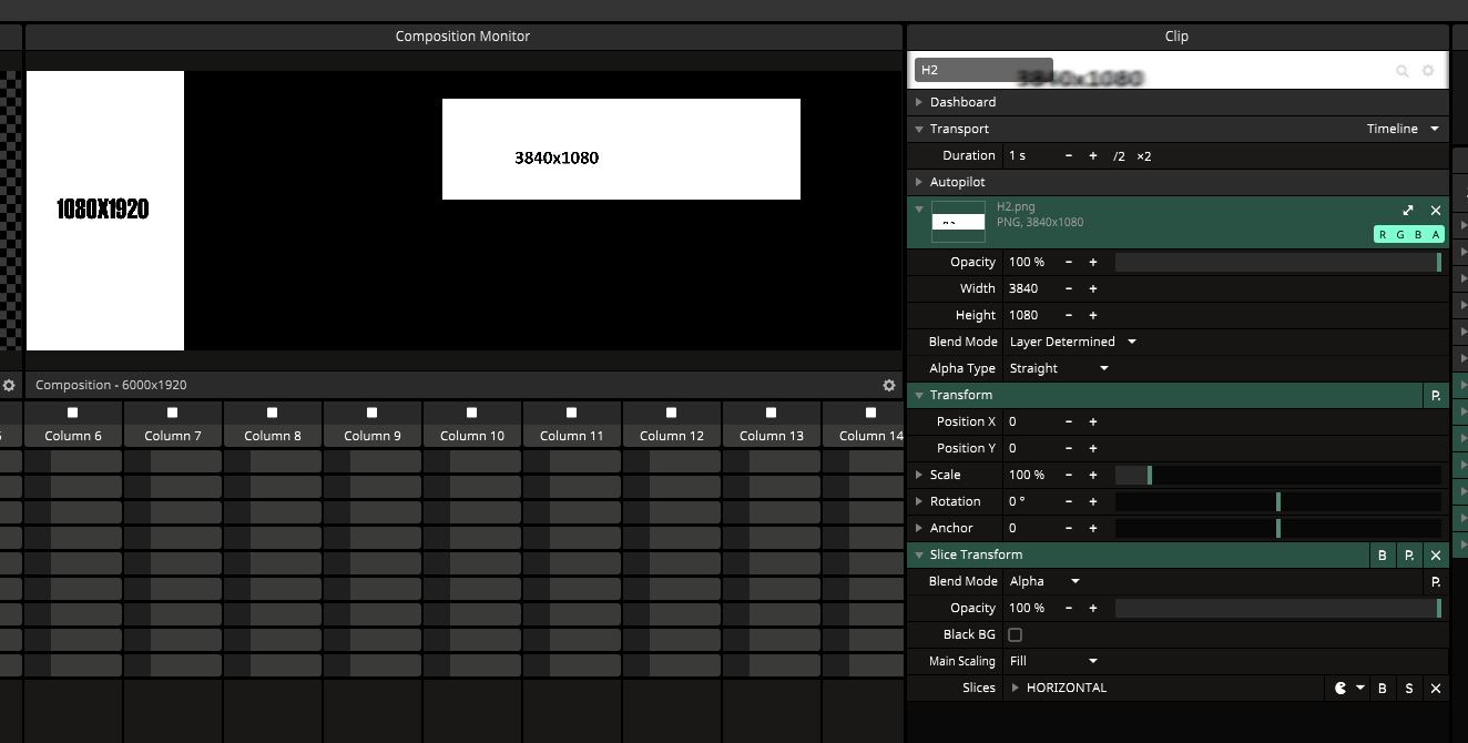

But even at the 3840x1080 size, it became smaller despite the artwork being at the correct resolution, and when I used SliceTransform to increase the size, it filled in, but I noticed that when working with the scale, it doesn't stay centered.

Do you have any scaling on the layer/group/composition level going on here?
Can you share your project file (composition and advanced output preset) - feel free to attach here or send to mail@resolume.com
Posts: 7821
Your transform is after the Slice transform, so the scale happens on the whole texture, not only the area of the slice. At that point your texture size would be the same as the layer resolution.
The first SliceTransform / Transform effect of the clip will render into the layer sized canvas. The next effects will then work with that texture.
We're looking into the option to be able to scale slices inside the slice transform.
