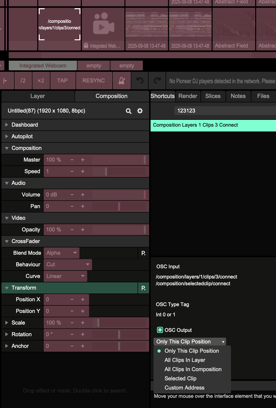

you can create custom OSC presets to send specific items only

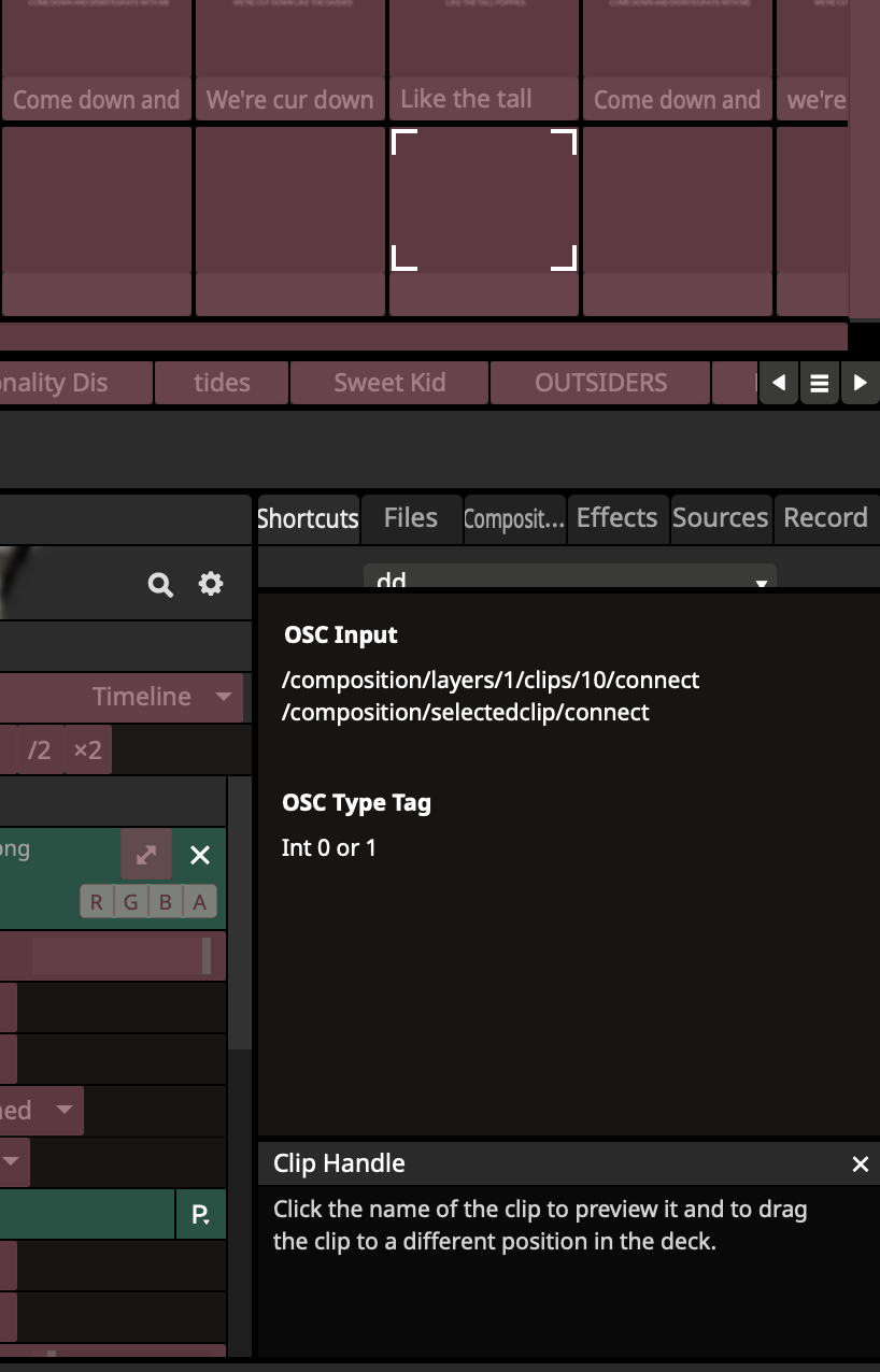

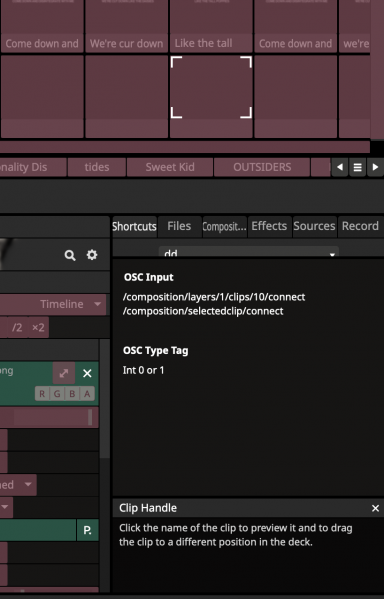

Where is Custom OSC found? It doesnt seem to be in the shortcuts window, I've turned off all messages, but when I click on a field, its just has the default path in it and no way to edit it. It looks like a different UI to me...
Re: Choosing osc to send instead of all or none
If you create a new OSC preset, that will be your "custom" one.
Clip triggers are easy to map, you can click on a clip thumbnail, and then select all clips in composition. That's one shortcut for all clip triggers.
I see nothing like that...
