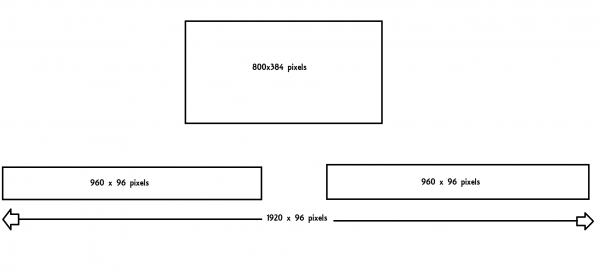

I am looking for some ideas as to whether the following setup is possible without a capture card.

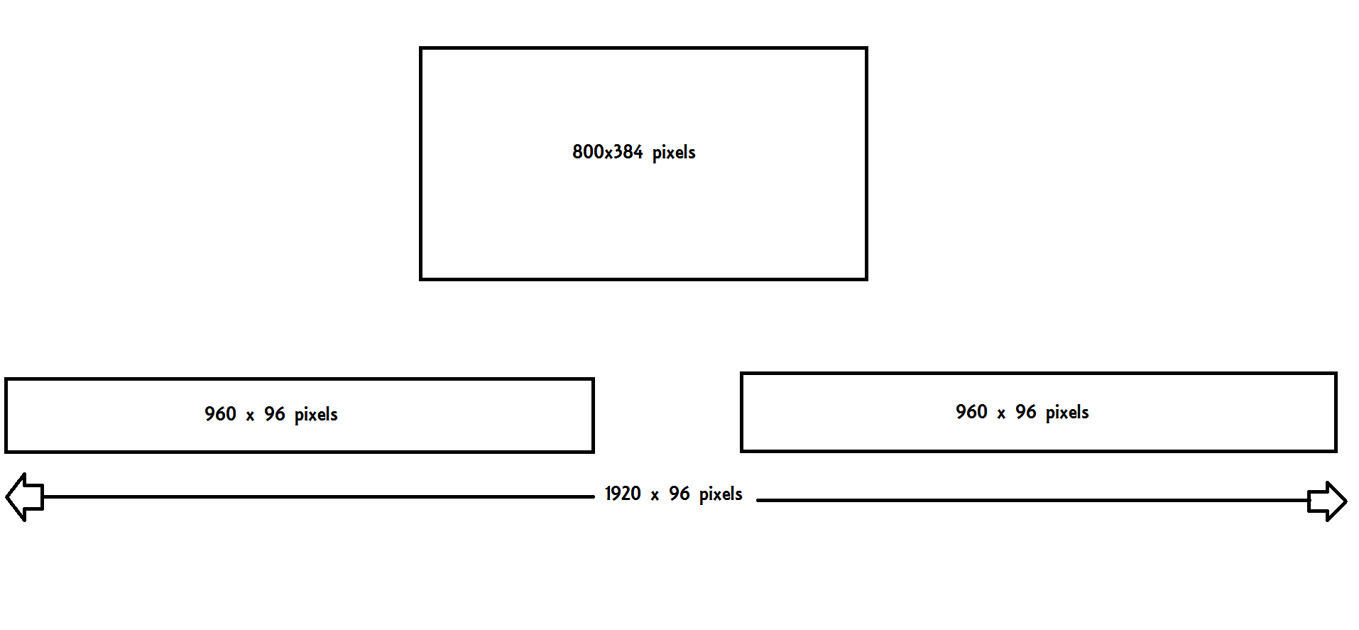

There is a 800x384 pixel LED wall and a 1920 x 96 LED wall both of which will display the same content throughout. Now normally this is not a problem as i can connect my PC running resolume through a splitter to the LED video processors.
However this particular 1920x96 LED wall , due to LED sending card constraints has been connected using a Matrox Dual Head2Go. So basically there is a video processor driving the 800x 384 led wall and two separate video processors driving the two 960 x 96 led wall ( but effectively a single 1920 x 96 led wall).
As the matrox input signal needs to come from the PC running resolume, i cannot use a splitter.
Is this setup possible without having to use a capture card?
Is this setup possible without a capture card?

The led processors running the two 960 x 96 led walls have the output of the matrox dual head 2go as their input. So basically the first 960x 96 led wall shows the first half of the image and the second 960x96 led wall shows the second half of the image. Since the two 960x96 led walls are connected via the matrox i have to keep the matrox connected to the vj computer.
I'm sorry but i didn't quite understand the Combining the 960x96px strip and the 800x384px wall into one 1024x768px composition
