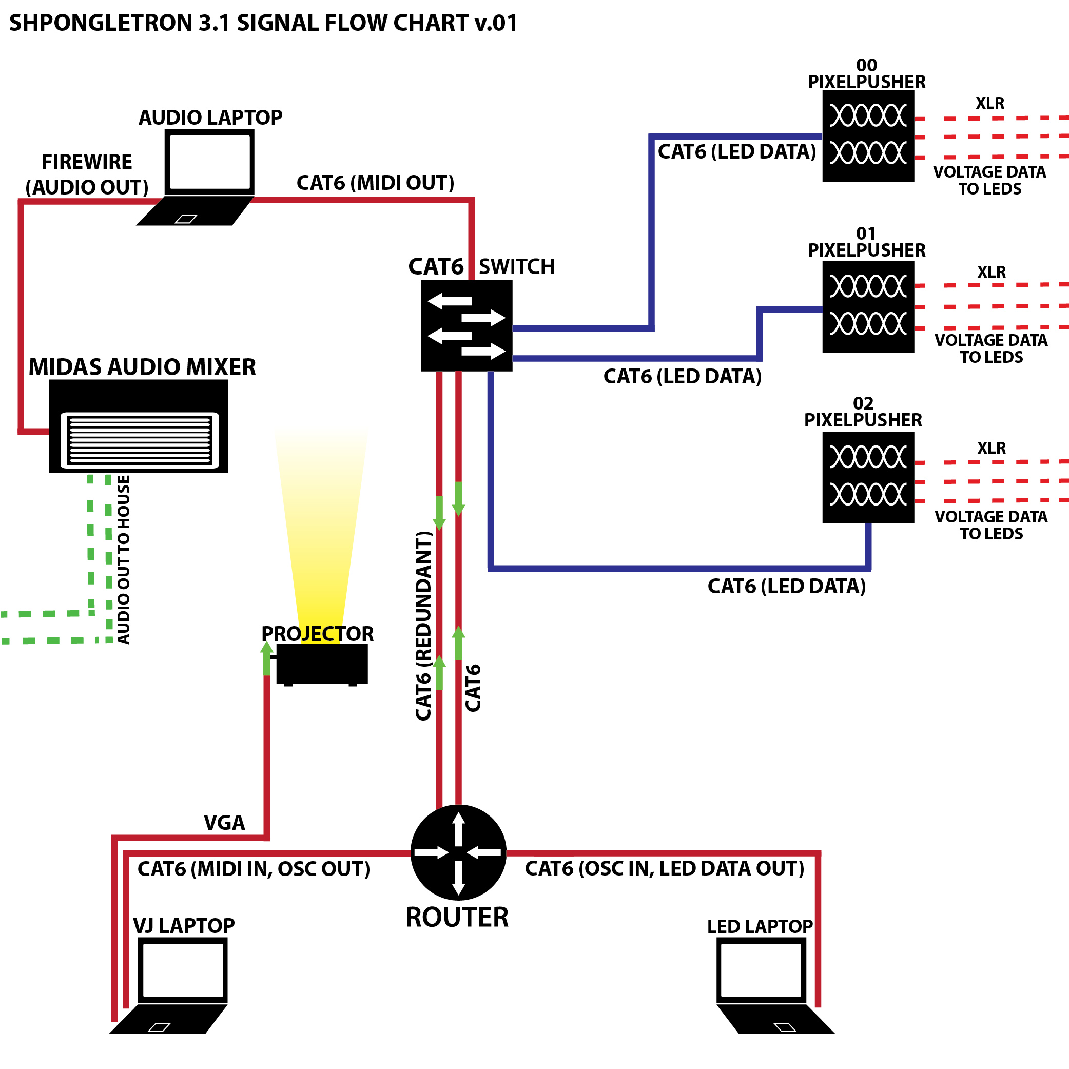

Just to be clear though - there shouldn't be any feedback happening from one machine to another - master computer (Arena) is only controlled by the Ableton computer sending it MIDI triggers - so it's not getting any OSC messages, just sending them to slave computer (LED video clips) after those keys are triggered by MIDI from Ableton computer.
Here's a graph of our signal flow by the way, for easy reference:
My current whitelist of OSC commands is as follows:

Could any of these be responsible for resetting all of the bpm on the slave computer clips?
The sets on both computers are identical in layer and column numbers, but have clips with different resolutions and titles. My biggest problem is genuinely the inconsistency of it all. As I've mentioned, this crazy gordian knot of a configuration works perfectly well (we preview audio coming out of all 3 computers all at once, and it's perfectly synced up, down to about 10ms or better) 90% of the time. Then, out of the blue, some of those issues I've mentioned might happen; where just the night before - they wouldn't.
I will try to create an OSC dump program on the slave computer, to see if there's anything unwanted sneaking through, but in my understanding - there shouldn't be any OSC message out there that resets all of the BPM counters, is that correct? Just want to figure out where to put a priority marker in my observations.

Wish there was an easier / more stable method of syncing without resorting to MIDI networks and OSC whitelists, but all of the experiments we did with SMPTE would not allow us to mix between clips.
Z.
