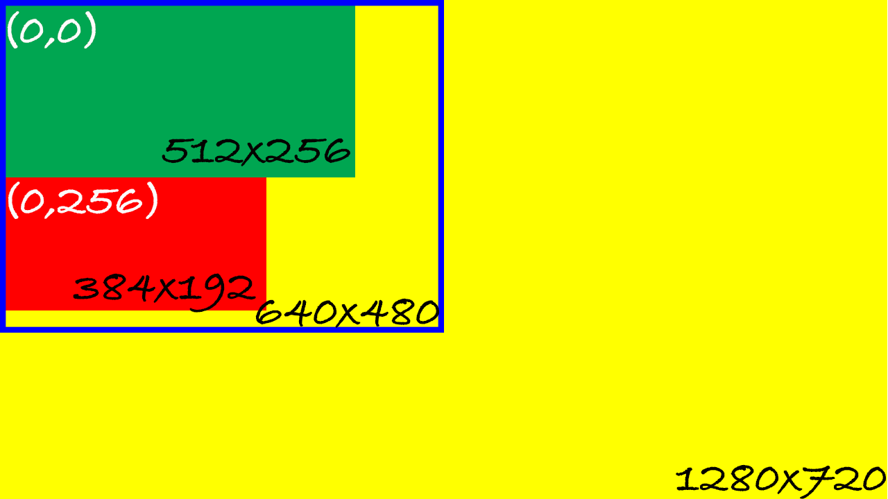

If you want to send two different videos on one output and each video has a different resolution, you need to built your output so that you know the location of each section so that you can select it in your video processor down the line.
If your LED processing unit can't breadown the output into 2 screens you'll need to add a video processing unit in the middle to do that such as a Datapath X4 or a BARCO Image Pro II with Dual Ouput but these are expensive pieces of equipment that will run you from $1,600 (Datapath X4) to over $10,000 (Barco Image Pro II)
Here is an example of how I would break it down with the top left coordinates in white as (X,Y):
Also, based on the size of your LED walls, it looks like you could send both screens on a 480x640 instead of a 1280x720.

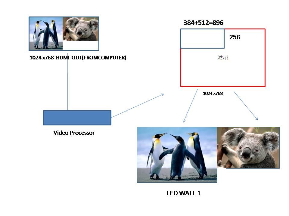

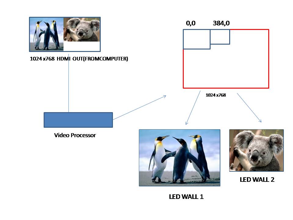

i think your idea represent image 1 .if i wire both screen as one screen(image2) . Can i manage it with slices? if yes.is that a correct way?
IMAGE 2
IMAGE 2
IMAGE 1
IMAGE 1

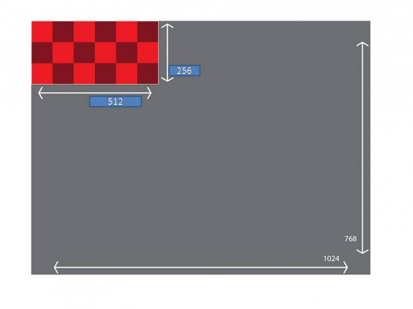

i am using led video processor.
it takes input video and resize it to led wall size.(512x256 pixels) then processor out the image with big resolution(example 1024x768) and resized video placed on 0,0 (x/y)coordinates.
processed image would like below image,
then processed image gives to send card in their it only capture 512x256 at 0,0 coordinates.
