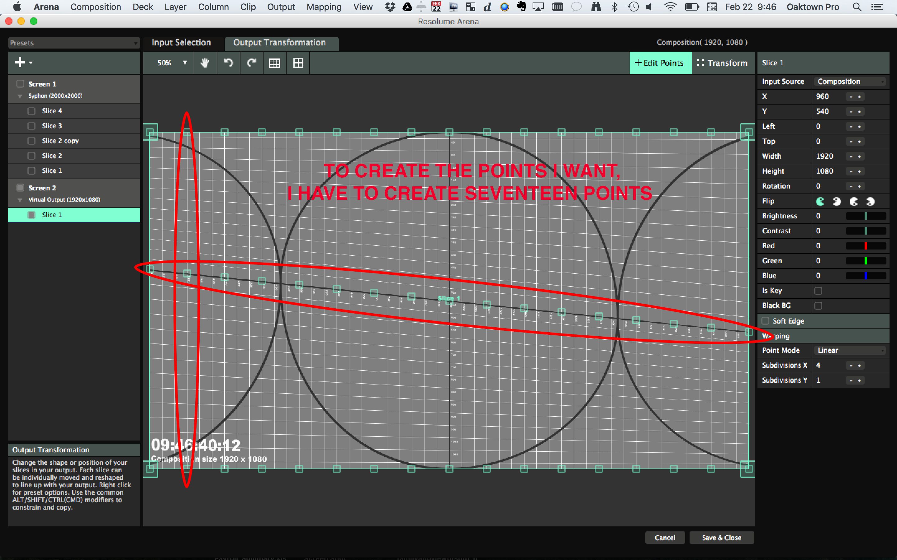

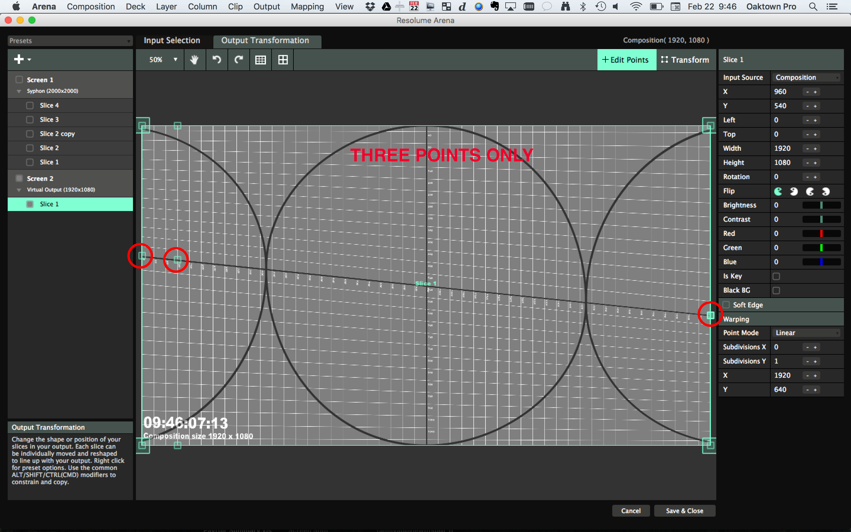

Hey Joris, thanks for your detailed reply. The main thing I'm after is being able to subdivide without being forced to do it many times to get a subdivision that's close to what I want.
Here are a few pictures to illustrate:
Ideally, I'd want to be able to define where my subdivision are to the pixel.

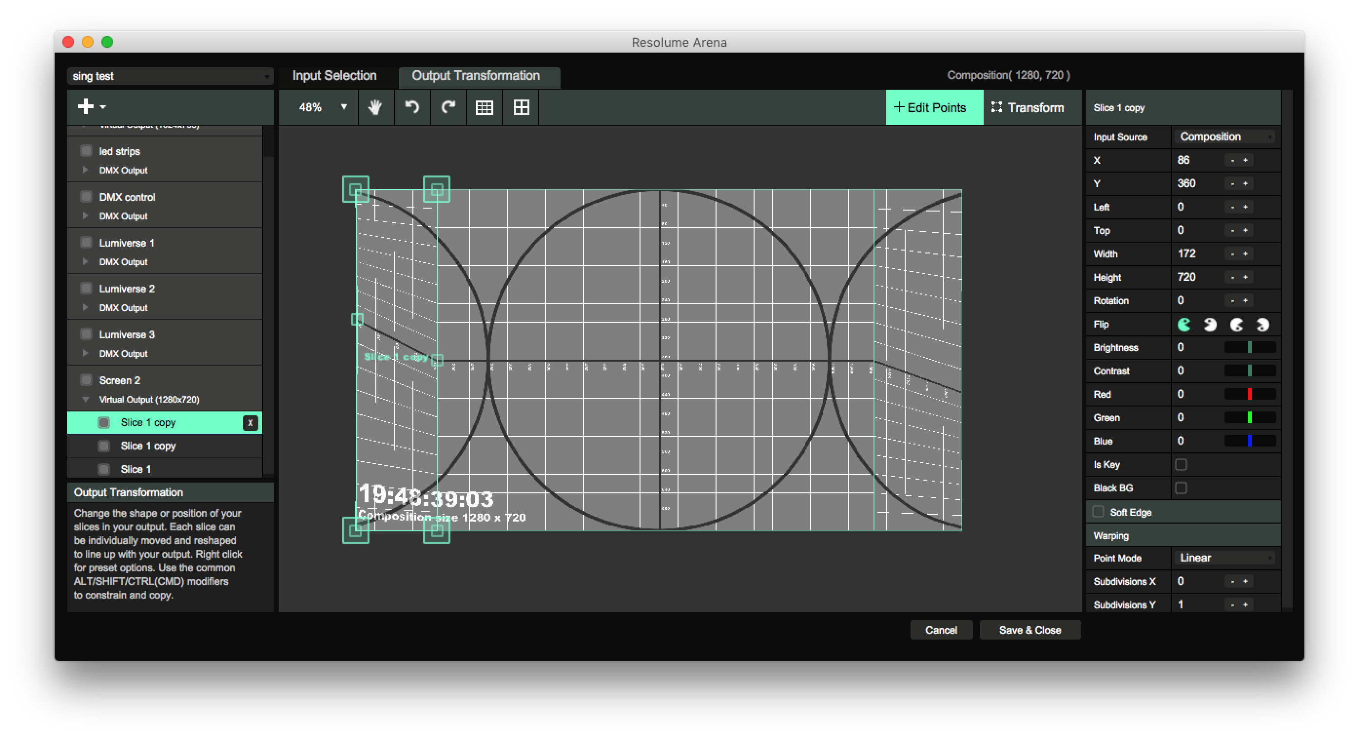

you could do that with 3 slices or not?
edit: snapping for warping points to other slice's warping points would help a lot with this.
