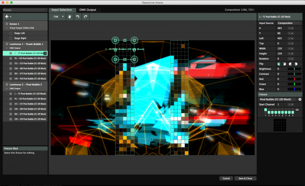

You can run a Showtec pixel bubbles 80 MKII with all the maximum number of LED strings (30 strings or 150 LEDs) with one universe each. If you have more than one Pixel Bubbl, all you'll have to do is to set the universe of the second Pixel Bubble to 2 and so on and so forth. Artnet control will be done via CAT5/6/7 cables and you can daisy chain your Pixel Bubble units
Then in Resolume you would define 5 X 5 RGB pixel fixtures like this: and stack them like this (up to 6 per universe):

Re: Newbie question regarding Artnet and Showtec Pixel bubbl
Hopefully that works for you!
I'm attaching the fixture just in case (Zip file). All you have to do is unzip and drop it in the Arena 5 [fixturelibary] folder located in the [Resolume Arena 5] folder.
Hey...just an update. After taking delivery of the bubbles and setting up profiles (which worked perfectly first time, thank you), we have decided to stick with DMX for the protocol for the bubbles. Resolute had started to crash randomly and lock up the computer. As we were also running ableton live for playback and our 2 universes of dmx software on the same machine, to take the chance of it crashing during a performance was unacceptable. Next year, we will definitely try to use this but we have less that a week to program a 2 hour show and don't have the time to bug find. Thanks for taking the time to help and the pixel bubbles displayed the video no problems although with obvious low res viewing.
