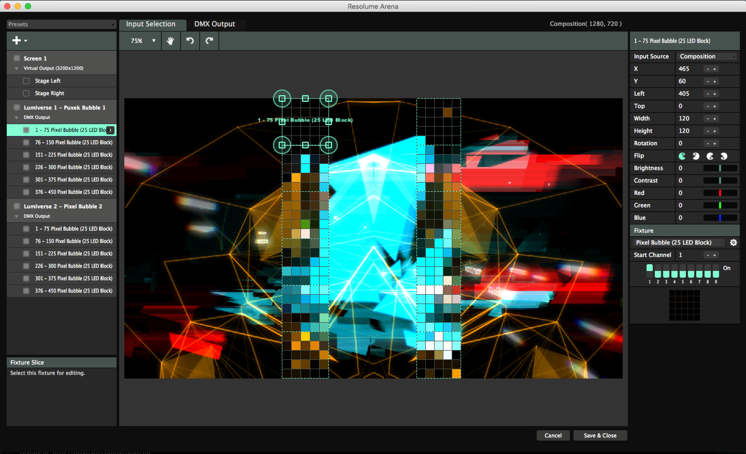

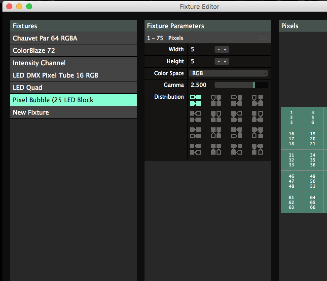

You can run a Showtec pixel bubbles 80 MKII with all the maximum number of LED strings (30 strings or 150 LEDs) with one universe each. If you have more than one Pixel Bubbl, all you'll have to do is to set the universe of the second Pixel Bubble to 2 and so on and so forth. Artnet control will be done via CAT5/6/7 cables and you can daisy chain your Pixel Bubble units
Then in Resolume you would define 5 X 5 RGB pixel fixtures like this:
and stack them like this (up to 6 per universe):
