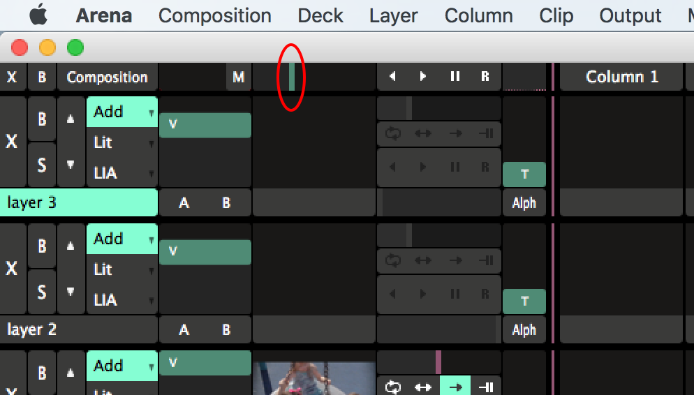

Right click on this bar to make sure your composition speed is set to 1:
