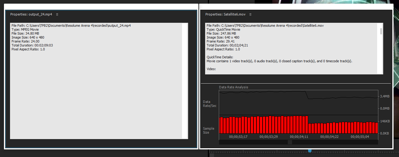

Unfortunately using handbrake.fr to switch the file to constant frame rate did not solve my problem >_< I thought for sure that would fix it...
It does show on the properties of the file that it has changed the file to the frame rate that I set in handbrake - I choose the closest option to the listed FPS of the resolume recorded file...
I believe Jordis when he says it writes variable framerate files: what I see in Premiere is that the Data Rate/sec on the file directly out of Resolume is variable
Premiere video file properties
(and has to do with bits not FPS?) whereas after processing with handbrake that section isn't present. This could represent what is being referenced... however I can't seem to find any kind of software that will tell me "hey this file is variable fps" - "this one isn't"
