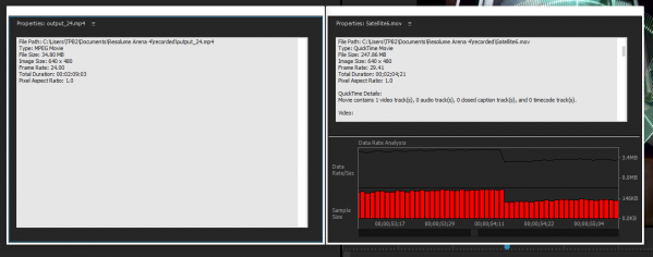

Unfortunately using handbrake.fr to switch the file to constant frame rate did not solve my problem >_< I thought for sure that would fix it...
It does show on the properties of the file that it has changed the file to the frame rate that I set in handbrake - I choose the closest option to the listed FPS of the resolume recorded file...
I believe Jordis when he says it writes variable framerate files: what I see in Premiere is that the Data Rate/sec on the file directly out of Resolume is variable
- Premiere video file properties
(and has to do with bits not FPS?) whereas after processing with handbrake that section isn't present. This could represent what is being referenced... however I can't seem to find any kind of software that will tell me "hey this file is variable fps" - "this one isn't"
