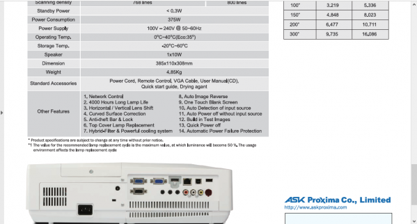

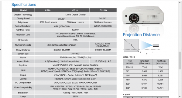

Hi all.
Please have a look at the attached Proxima C510W specs and advise if it is good enough to run video mapping at small/medium sized clubs. They are cheap and I want to try to buy at least four of them.
Thank y'all for reading my post.

There are so many variables involved in choosing the right projector that without knowing exactly what you're after it's hard to tell you whether this particular projector is fine for your application and quite honestly it goes beyond the scope of this forum.
That being said, I can give you a few pointers:
  • - At 5,000 to 5,500 lumens the projector should be bright enough to get nice images up to about 10-12ft wide in environment with controlled lighting but you'll need to make sure you don't get too much bounce and that you have good projection surfaces.
    - It has a high contrast ratio (5,000:1) so your black will be dark and your colors vibrant
    - It has H/W lens shift so it'll be flexible (+/-10% H and +/-40% V)
    - You can't change the lens so unless the 1.48~2.47:1 works for you, don't buy it!
    - It has an HDMId port but no HDBaseT so if you need to send your signal from a farther than 15ft, you'll need to buy adapters
