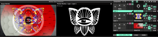

A few things:
1) When I select either active modes of Layer Mask (One Below or All Below), all the clips in the layer becomes B/W
2) If I select Layer Mask>One Below and there is no clip below, my layer is still masked
3) If I select Layer Mask>One Below and insert a 100% alpha clip my Masked Layer is completely black so both black and transparency have the same result
4) If I select Layer Mask>One Below with a black mask in the layer below, a white clip in the layer below the mask, set the masked layer to 100% Add, and the masked layer and the mask are grouped I can see the white clip as if the masked layer was in 50% alpha. But if I move the white clip into the group below the mask, it behaves as expected.

Setting the Mask Mode option for a layer means that *that layer* becomes a mask, for either the layer below or all layers below it. 'All Below' is essentially the same as setting the layer's blend mode to 50Mask. 'One Below' is essentially the same as a Luma Matte in After Effects. 'One Below' makes it possible to use a single layer as a mask for a another single layer, instead of using some convoluted layer router structure.
The thumbnails and previews turn B&W because it uses the luminance channel for the mask. If the content in the Mask Mode layer has transparency, it's treated as black.
4) I don't fully understand what you mean here, but maybe the explanation of what the Mask Mode option actually does, has helped a bit?
