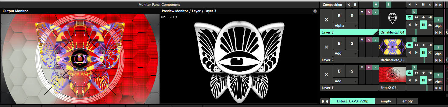

Setting the Mask Mode option for a layer means that *that layer* becomes a mask, for either the layer below or all layers below it. 'All Below' is essentially the same as setting the layer's blend mode to 50Mask. 'One Below' is essentially the same as a Luma Matte in After Effects. 'One Below' makes it possible to use a single layer as a mask for a another single layer, instead of using some convoluted layer router structure.
The thumbnails and previews turn B&W because it uses the luminance channel for the mask. If the content in the Mask Mode layer has transparency, it's treated as black.
4) I don't fully understand what you mean here, but maybe the explanation of what the Mask Mode option actually does, has helped a bit?
