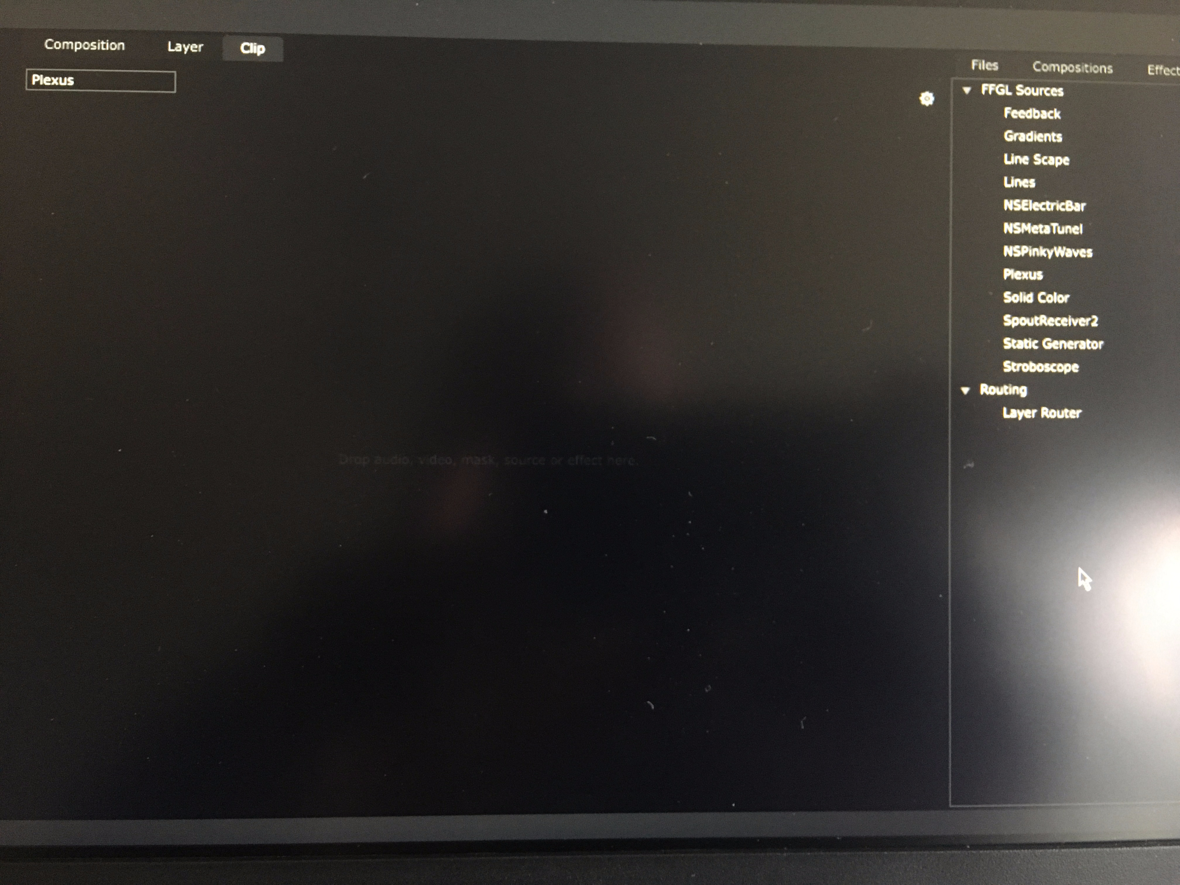

ok so I have 24 hours before getting on a plane for a gig and I decide to give my set one last go, I open up Ableton and Resolume and wtf... All clips in my Resolume project that rely on external VFX such as Plexus are empty!
The clips do still have their original names but they appear to be empty.
See the attached pic for an example, I this is a Plexus clip and you can see in the browser to the right the VFX are installed correctly.
I'm absolutely sure I haven't changed a thing since my last performance and rehearsals, does anybody know what weird bug this is and more important: how to quickly fix it?

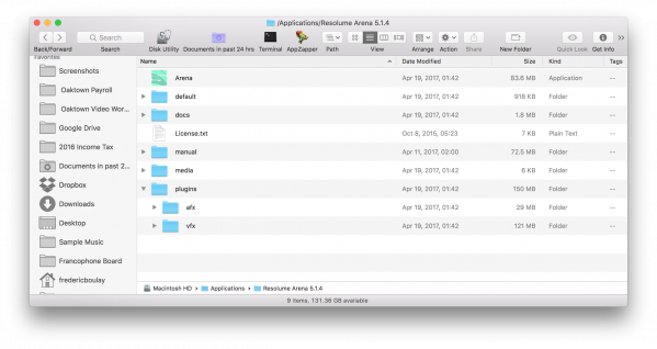

Did you make any changes of hardware or move the main Resolume folder in your application folder?

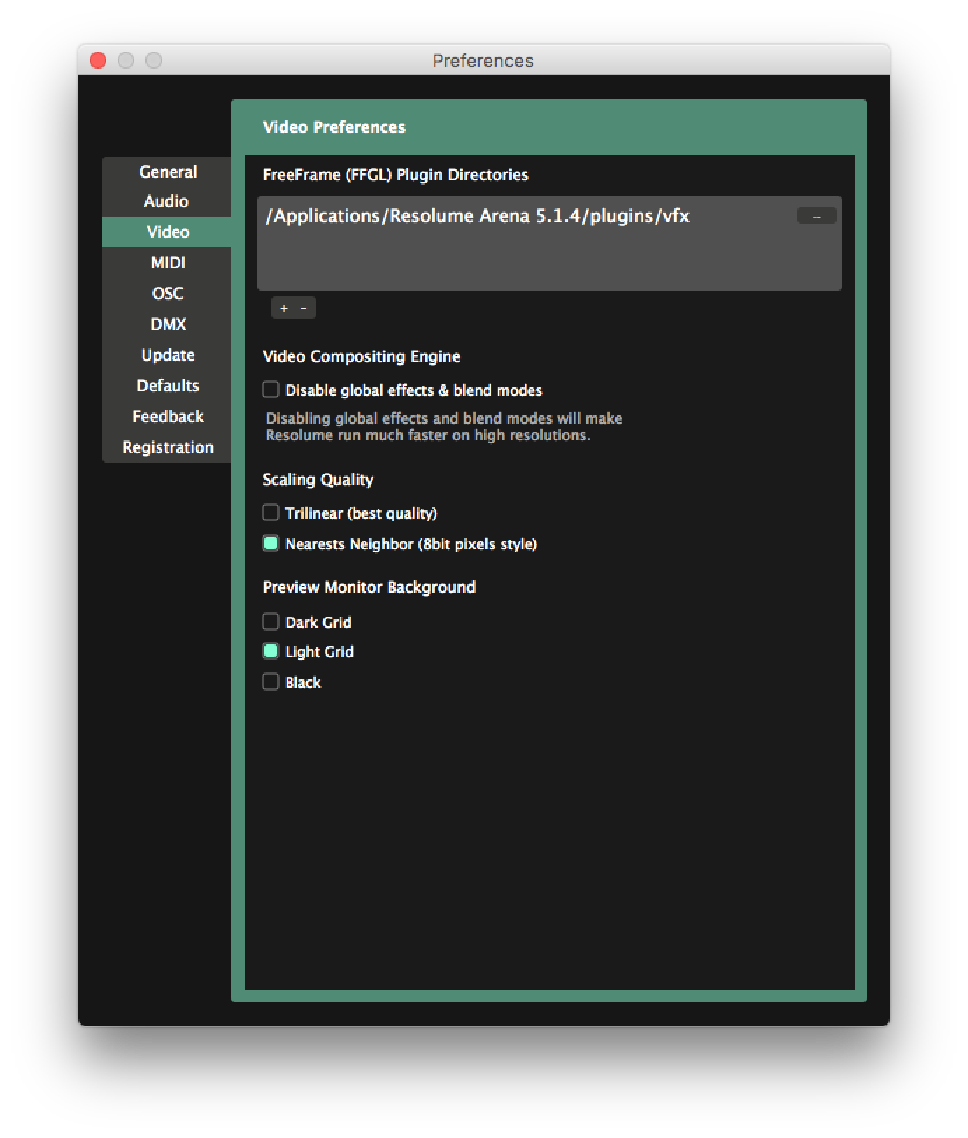

Open Preferences and go to Video to make sure it's pointing to the right directory.
If not, to reconnect your VFX (assuming they're still on your computer), click on the [+] and find the folder which should be located in application/Resolume Arena 5.1.4/plugins/vfx (or afx).

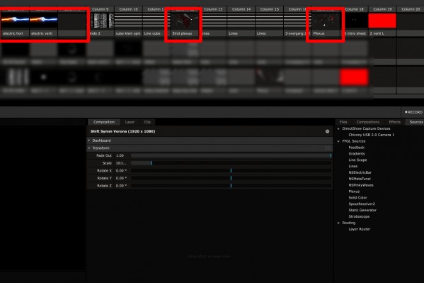

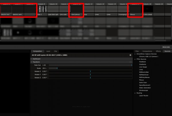

Here are two screenshots, one of the affected composition, one of an older good version.
Ravensc although your suggestion seems logical I can't recall changing anything from the file system, it seems completely random...
The red boxes are the affected clips: as you can see the vfx are present in the browser and working on other projects:
