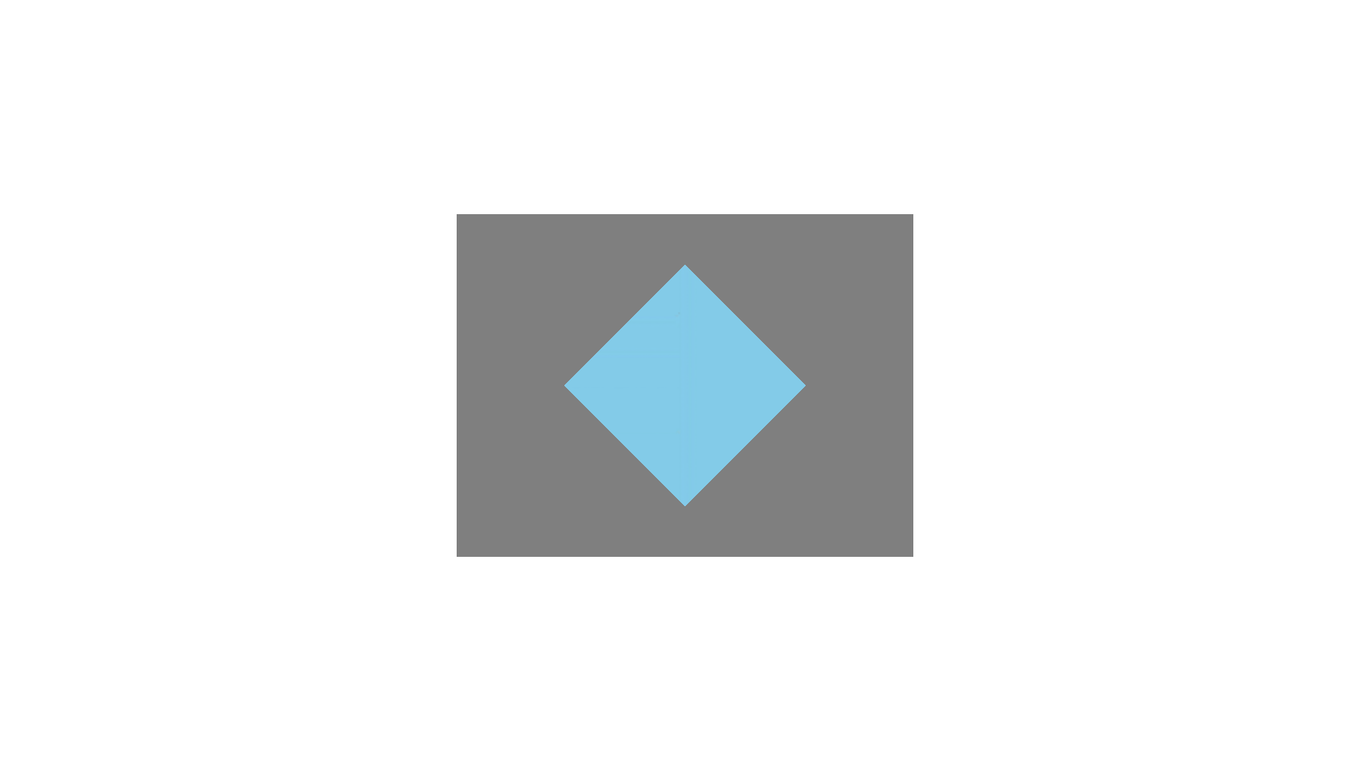

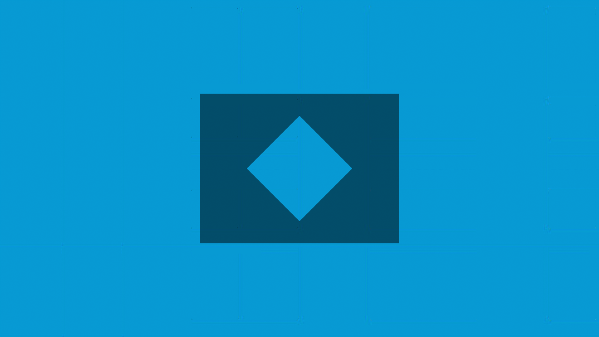

Correct!Menno wrote:I think what you guys instead want is for transparency in the destination texture to be treated as 'there's nothing here to multiply with' rather than 'there's nothing here, so multiply with the premultiplication color (which happens to be black)'
That would mean that using the same two files, if I adjust the opacity of the mutiplied clip to 50%, I would get the following result (which is what I get in both Adobe Photoshop and Dataton Watchout): instead of:

And at 5% clip opacity I would get this: All that being said, the ability to multiply with just alpha where a=1 create full transparency on top of any color and a=0.5 create 50% transparency would be a great effect on its own especially with groups!

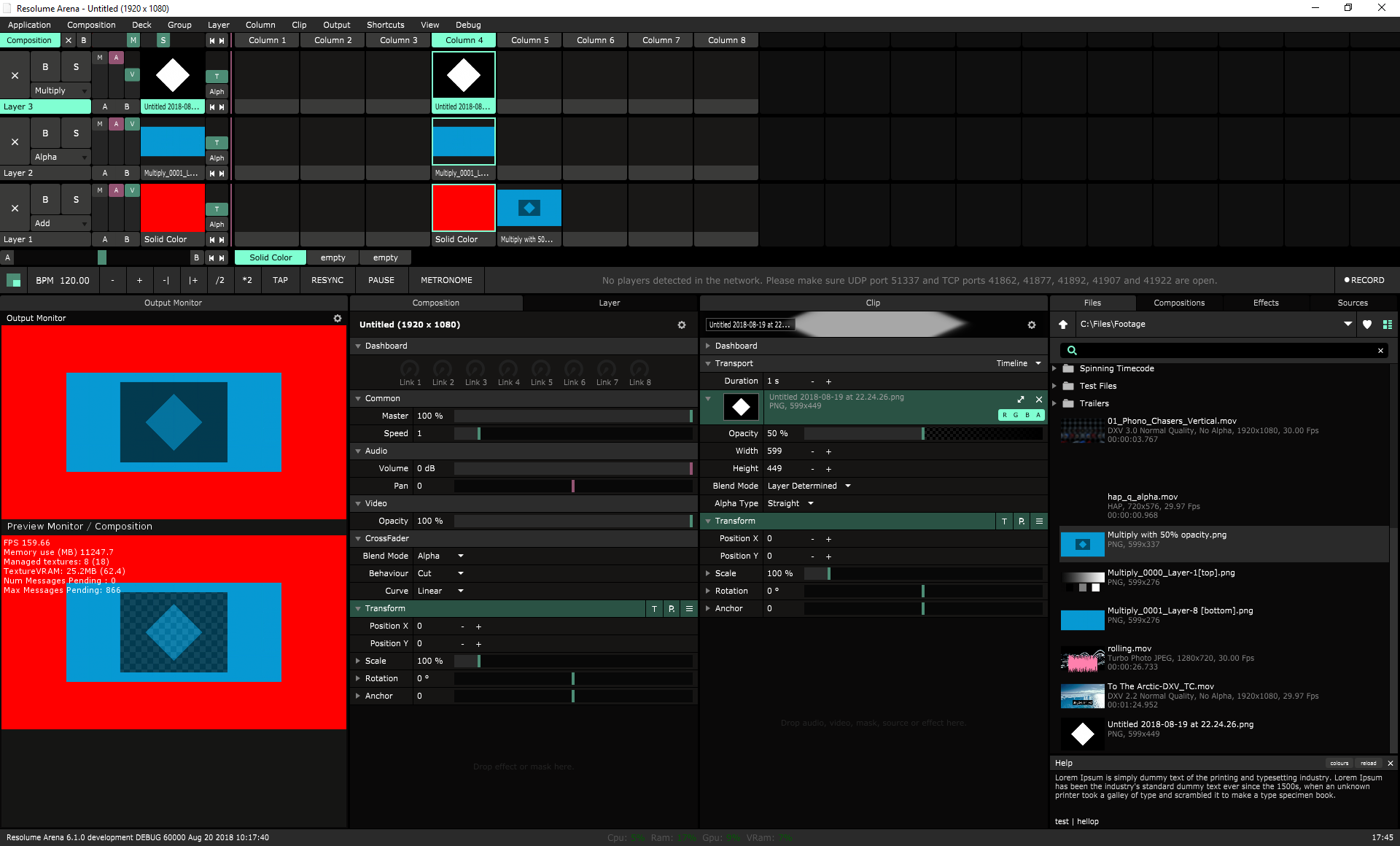

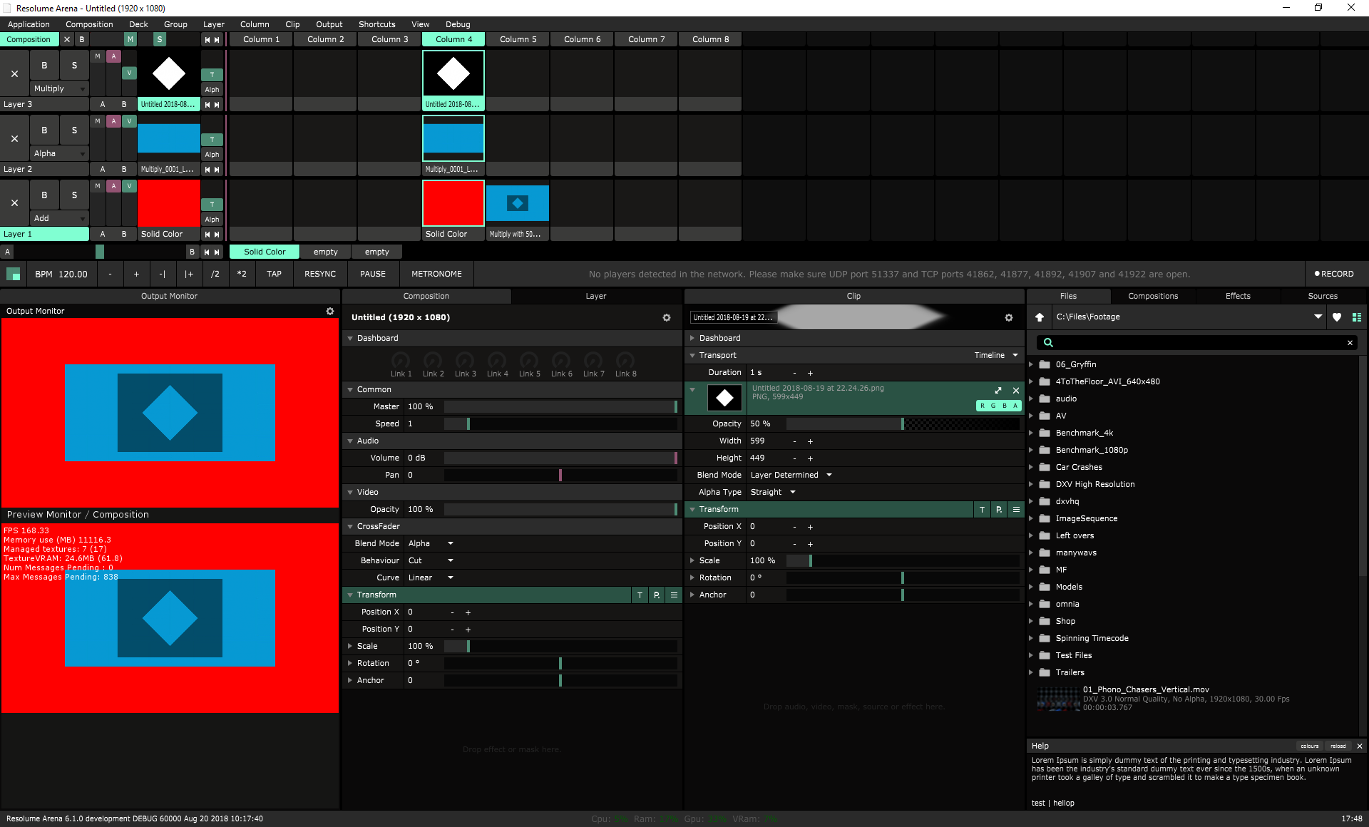

I've just seen the problem has been fixed when you use the general blend mode but not when you use the clip blend mode.
Let's say I want to use on layer 3 screen blend mode and I'm forced to have a clip on layer 3 that requires a different blend mode, let's say multiply.
If I tweak the blend mode of the clip changing it from layer determined to multiply when I play that clip
I still see the jump.
Please fix that part as well!!!
Having the chance to bound the blend mode to the clip is a very USEFUL feature that prevents you to mess the projection when you are doing things very fast during a performance.
Please let me know what and when you'll be able to fix it.
