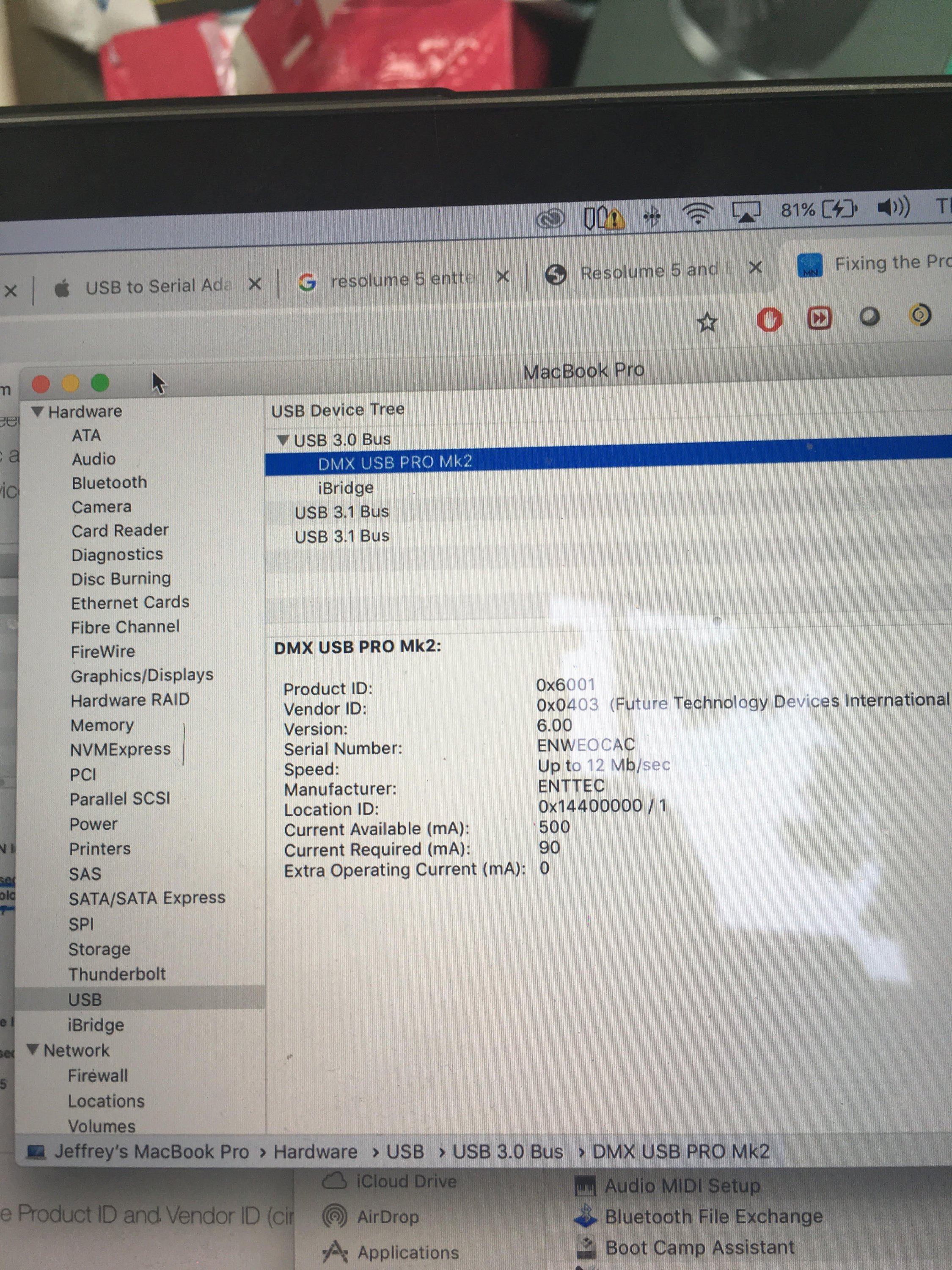

So I spoke with Enttec and they said it might be a conflicting driver with resolume. This what he said:
" It's just that it's possible that Resolume requires different drivers than Pro Manager, and subsequently our software. If they can specify the driver necessary, I will try to help you get it installed."
Any idea of what the drivers are so he can better help me? I've attached my system info if that helps. Thanks

Pretty much they wanna know what driver resolume us is using to see if its conflicting with the mk2 pro so they can help me.
I've found this in an email from 2015...
Long ago, we used Apple's d2xx drivers drivers to connect to Enttec devices. This was confusing to a lot of users, because Enttec themselves said to use a different driver set. So we changed it. We were in sync. Things were good. It was a happy time.
Then, around the release of Mavericks. Apple decided to only allow their own set of drivers, and disable all apps using their own drivers. This included Enttec. Enttec didn't know what to do for the longest time. Even their own website still says the USB Pro will not work on El Capitan. But, when you download Pro-Manager, it says their devices are now working with Apple's own drivers on OSX. For us, this means we have to go back to our old code.
So looks like there was some driver changes going on in Resolume versions around that time.
Version 5.0.2 and above should use the Com drivers, as I understand.
You can get the installer here: https://resolume.com/download/files?fil ... taller.dmg
We added support for revB devices with 5.1.0. You can get the installer here: https://resolume.com/download/files?fil ... taller.dmg
The latest one is 5.1.4: https://resolume.com/download/files?fil ... taller.dmg
I hope this helps!
