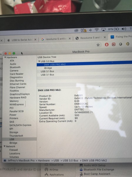

So I spoke with Enttec and they said it might be a conflicting driver with resolume. This what he said:
" It's just that it's possible that Resolume requires different drivers than Pro Manager, and subsequently our software. If they can specify the driver necessary, I will try to help you get it installed."
Any idea of what the drivers are so he can better help me? I've attached my system info if that helps. Thanks
