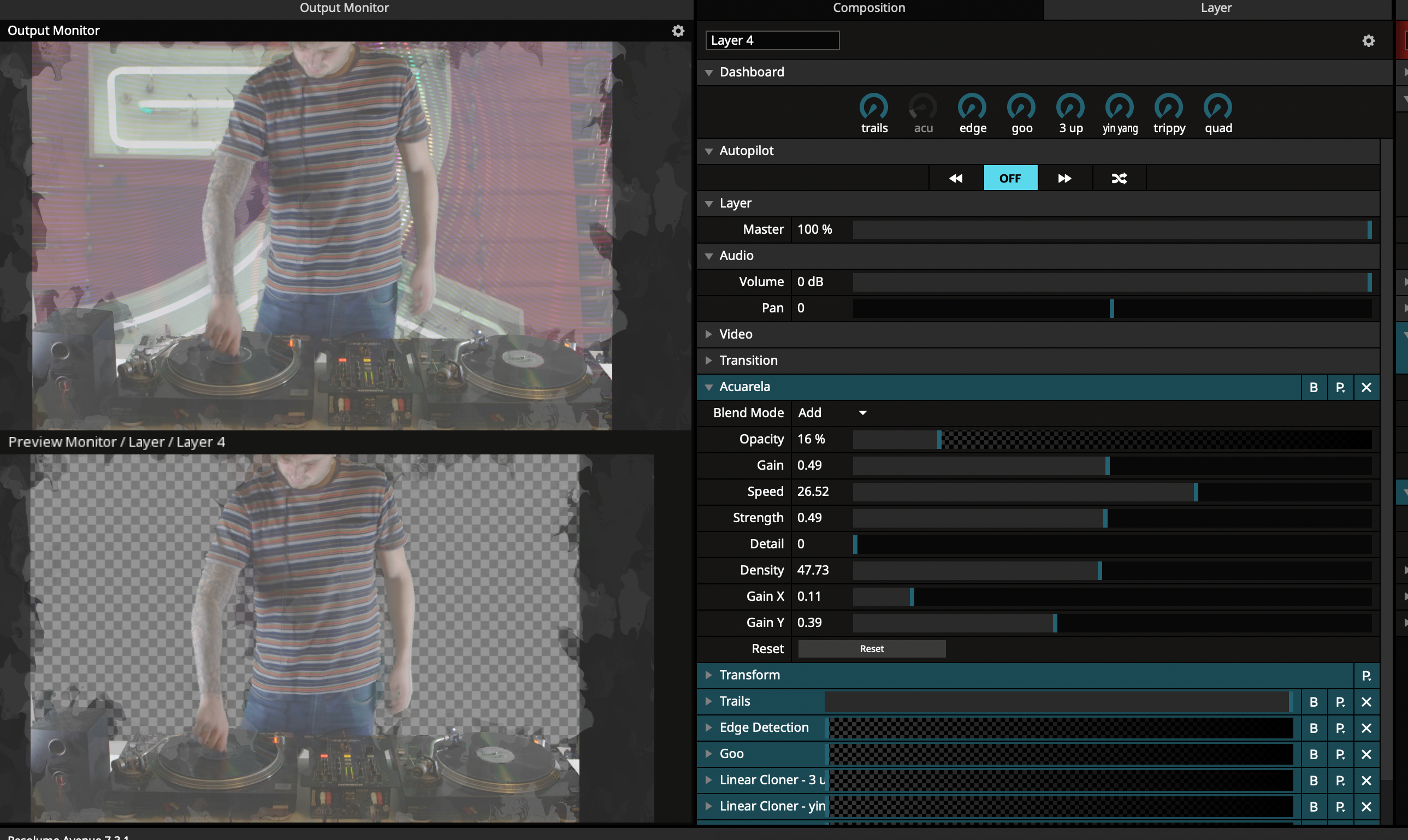

I'm still getting a lot of nasty white in areas that where previously we were nicely transparent - is this something I can fix?
This white was not present in the previous version of the effect - it was just lots of lovely trippy smokey goodness on the edges!!
Is this something I can amend by changing settings?

Try changing the Blend mode in the effect, or move the opacity slider.

Thank you Zoltán. The opacity in the example is set is at 16% - doesn't seem any of the blend modes are helping. Is there one you can suggest to remove this?
The subject is keyed out and the alpha is now generating white where it wasn't before the effect update. Doesn't look like it has having the same effect on clips without Chromakey effect applied.
