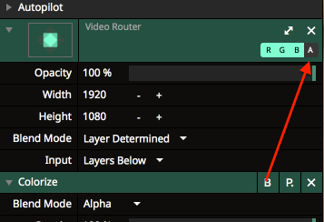

Posts: 7767
Re: Effect Clip not applied while transition happening
Thanks,
so, what happens is
while the clip below is starting to fade in, it's a semi transparent red,
the colorize makes a semi transparent white from that
and these are then mixed together using the 100% ADD(which is essentially alpha)
The result is a semi transparent pink-ish texture. If you preview the composition, you can actually see the checkerboard in the preview monitor.
That's how the mixing and transitions are expected to work.
What you can do, would be either adding the Colorize effect to your content layer, or
disabling the Alpha channel on the Colorize effect clip:
Képernyőfotó 2021-03-09 - 8.44.43.png (26.84 KiB) Viewed 6366 times

Hmm,
Ok. I thought this should work a bit differrent, but see the logic.
