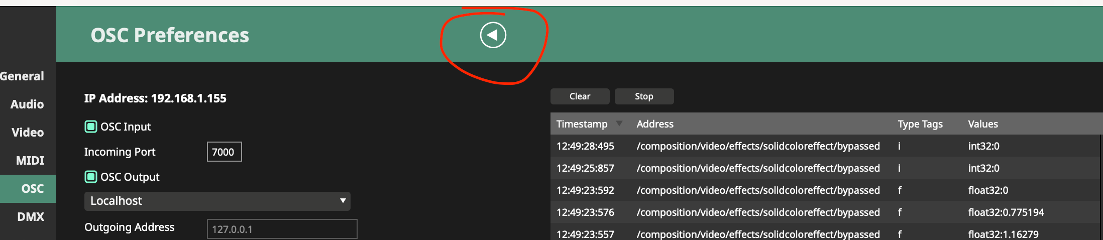

Do you see the OSC message come in in the OSC preferences - Inspector?
Re: TouchOSC — Bypass Effect in Arena 7
No — this area is completely empty …
The strange thing is that controlling of other parameters is possible. I can even change the color in the “solid color effect” — but opacity and the bypass button are not responding …
Do those incoming messages appear in the OSC inspector?

Sorry for being stupid — but when should these incoming messages appear in the OSC inspector? When I for instance touch a button on my TouchOSC?

OSC messages should appear when Resolume gets one.
Ios versions of touchOSC had an issue where long addresses were not sent out properly, maybe that's why they don't come in.
