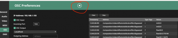

Do you see the OSC message come in in the OSC preferences - Inspector?

No — this area is completely empty …

Sounds like Resolume doesn't receive the data then.
Is OSC input enabled?
Are firewalls off?
Are you sending to the IP address of the machine from touchOSC?

Do those incoming messages appear in the OSC inspector?
Which touchOSC are you using and which OS are you sending from Android, or iOS?

Sorry for being stupid — but when should these incoming messages appear in the OSC inspector? When I for instance touch a button on my TouchOSC?
I am using TouchOSC MK1 from Hexler version 1.9.12.19 on an iPhone.
Posts: 7669
Re: TouchOSC — Bypass Effect in Arena 7
OSC messages should appear when Resolume gets one.
Ios versions of touchOSC had an issue where long addresses were not sent out properly, maybe that's why they don't come in.
