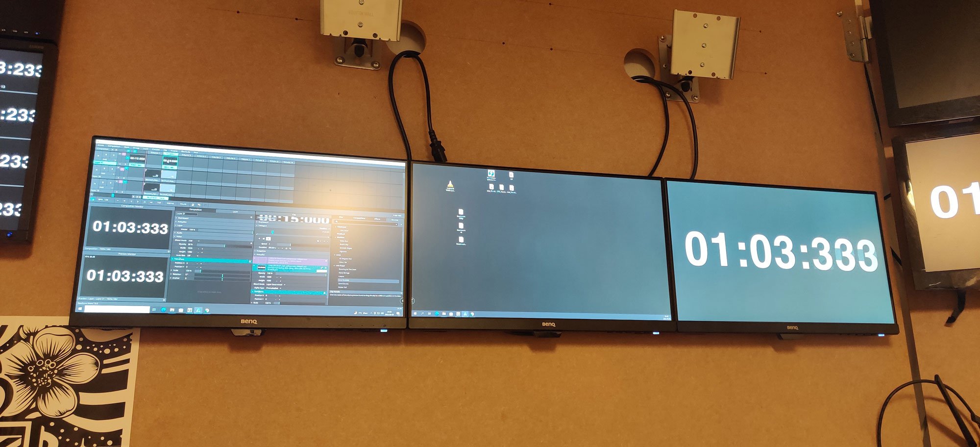

When I start up Resolume and launch a clip with MM.SS.MS counter, open advanced output and add both quad 2 card as outputs (any of the cards actual ports) and If I have all monitors in a cluster with the clip running, and then I use my phone to snap a photo of all monitors/outputs to see latency.
These are my findings!
GPU 1 (PCIE_1) shows 00.00.100 GUI + Discrete
GPU 2 (PCIE_3) shows 00.00.100 Discrete
SDI 1 (PCIE_5) shows 00.00.200 ±20ms On any output
SDI 2 (PCIE_6) shows 00.00.320 ±20ms On any output
Please see attached pics
Anyways, let’s move on! :-)

I can also mention that each cards 8 outputs where “almost” in sync. Please see attached pics of counter for reference.
