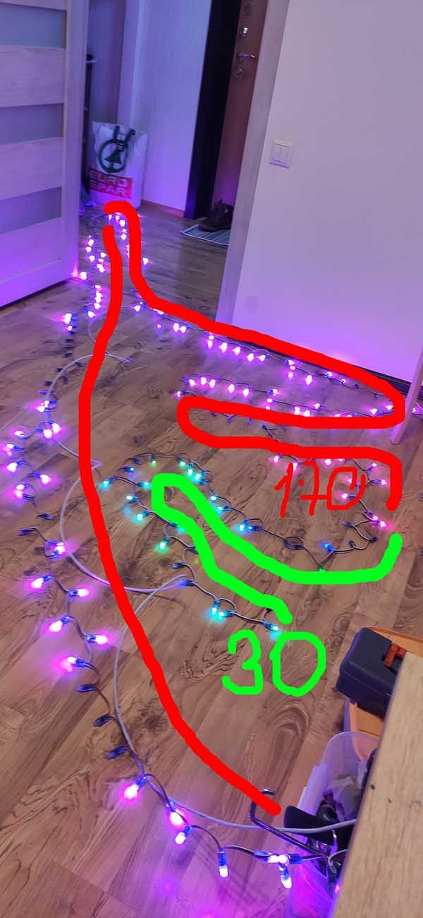

Hi folks!
I have a project with H802RA artnet SPI Chinese led controller (4 out universes) and led pixels on ws2812 chip. Now I can only make 170 LED pixels in one universe or 510 channels at most. But the controller can support 1024 or even 2048 pixels per port. Chinese software like LED studio work without problems when there are more than 512 channels in the universe. But the resolume do not seem to be. I've tried different tricks but it seems I'm stumped. Is it possible to send more than 512 pixels into the ONE universe or to overlay channels of two different dmx fixture(like 170 for one fix and 30 for two fix). I have a task to make 200 RGB pixels per controller output.
Thanks for your attention!
